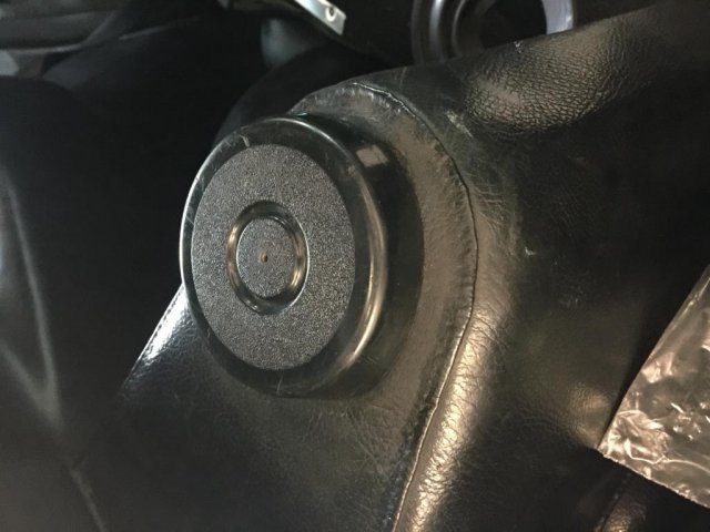

Soooo figured out a few things.  One, it's the diff, 2nd the rattling I thought was coming from the u-joints was actually coming from the rear bushings, which are gone, and slamming against the caps that are in the back.
 Now for the noob question, since I am new to all of this and get all my auto mechanic knowledge from the internet.  What are the bushings called?  They go on top of the shocks.  Also, are there any good videos out there on how to switch out the diff?  I can't seem to find any that make sense.
Thanks
Looking up some of the stuff that Seattlejester posted, the strut insulator mounts look exactly what the mechanic was talking about, but he was telling me the bushings on top of the strut need replace, and made it sound like the struts are supposed to move around in there, but I find that unlikely, because it looks like these mounts hold the strut in place.  This is so damn confusing.  haha
The strut isolator bushing is exactly as it sounds, it isolates the strut from the chassis so it doesn't transfer as much NVH. There's a strut cartridge on our cars, so it isn't one unit, but it shouldn't bounce around.
Can you take a picture? I'm kind of worried you might be referring to the mustache bar bushings on accident.

^Those are the bushing that go onto of the shocks, is that what you are referring to? Or are you thinking of the bumpstops?
So I think we may need to slow down here. Why did you want to remove the differential to change out the strut top insulators?
This is not really going to work if we have to guess at what you are looking at. Do us a favor and snap a few pictures with good lighting at what you are referring to, we would hate to recommend the wrong part.
I mean this would really help you get started in the correct nomencalture.
There are "bump stops" on the strut shock shaft.  If the car is lowered and the shocks toasted, "slamming" could happen.
The front struts have a bearing inside the insulator so the strut can twist.  The rears don't.

I mean even if the insulator deteriorates, it really shouldn't be bouncing around if it is tightened, unless it has crumbled apart and isn't seated.
The piece I posted is correct if it is your insulator, make sure you buy the appropriate one the 240z and 280z ones are different height.
So either the insulator has really fallen apart and it is loose and rattling around (at which point you really should stop driving and pull the suspension), or the shock is rattling around in the shock tube and needs the gland nut tightened or a spacer inserted in-between the gland nut and the insert.
