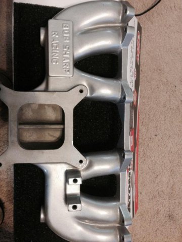

michael wales Posted July 15, 2015 Author Share Posted July 15, 2015 Thanks for the response, now are those AFR settings safe given the chances of uneven fuel distribution (that I haven't seen but am still wary of) with the 4bbl intake? I left the settings where they were to err on the side of caution. Quote Link to comment Share on other sites More sharing options...
Sovereign Z Posted July 15, 2015 Share Posted July 15, 2015 (edited) i think that's been chalked up to be a myth by many reliable sources. if you look at a BMW M20 engine, that thing has more bends and lengths than just about anything and it runs just fine. Edited July 15, 2015 by Sovereign Z Quote Link to comment Share on other sites More sharing options...
NewZed Posted July 15, 2015 Share Posted July 15, 2015 Isn't the fuel added at the start of the runners? The pseudo-carb? Should be the same ratio for all, unless air is slipping by without picking up fuel then passing to individual runners unequally. With mulitport injection, you could see a runner air flow imbalance. but equal fuel injected for all, leading to varying AFR per cylinder. Quote Link to comment Share on other sites More sharing options...
