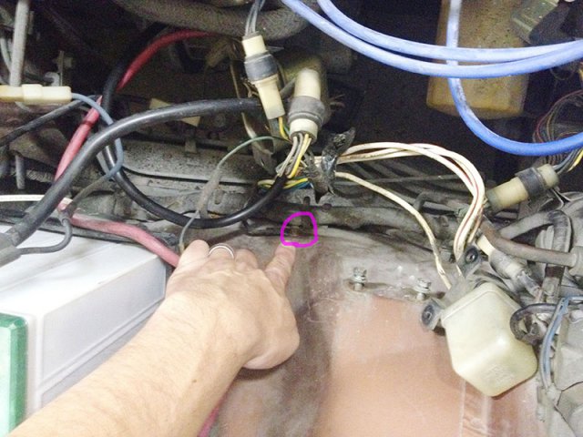

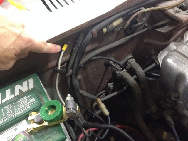

tamo3 Posted January 20, 2015 Share Posted January 20, 2015 As S30 SPL mentioned, clean up ground earth is good starting point. I recently did mine at it helps narrow down problem. from battery to body. from body to wiring. Quote Link to comment Share on other sites More sharing options...
