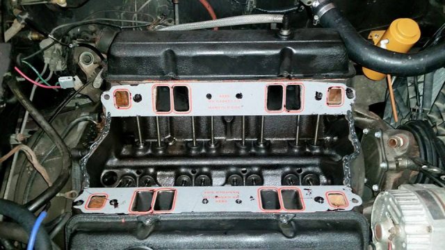

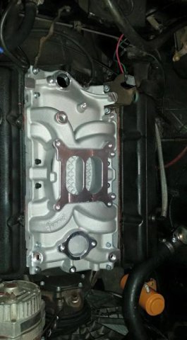

hwvigo Posted March 12, 2015 Author Share Posted March 12, 2015 (edited) Got started on the new intake and carb, just a quick update will give final results when i get it all buttoned up. parts : Summit Racing Street & Strip® Stage 1 Intake Manifold : Holley classic 750 cfm : ARP intake bolts : Mr gasket intake gaskets : Permatex High Tack Gasket sealant : Permatex ultra black silicone Edited March 12, 2015 by hwvigo Quote Link to comment Share on other sites More sharing options...
