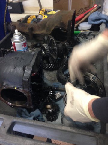

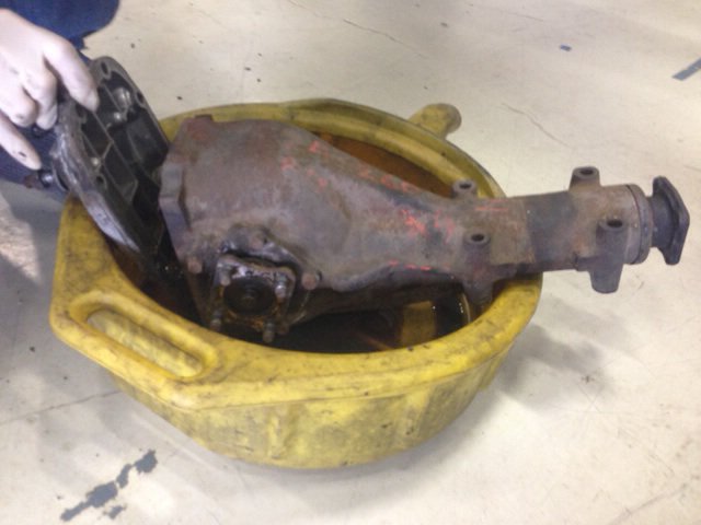

i should have the spur gears by tomorrow morning.
If I can get a few hours in, I should be able to remove the diff. replace gears and reinstall with the new R/T Mount.....

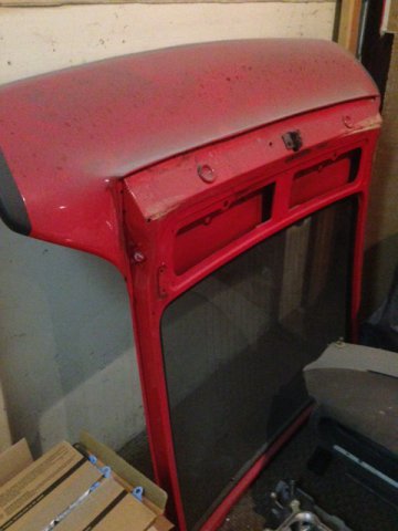

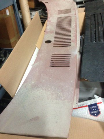

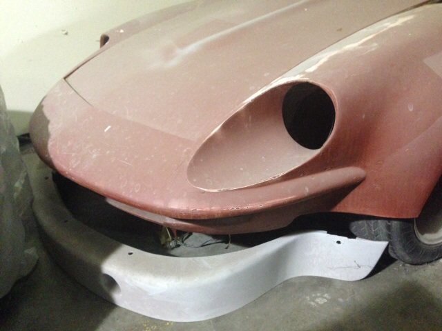

I went to the warehouse this morning to try and locate some usable door panels to no avail.
Found a hatch with wing, IMSA style front end and a cowl.
I've brought the cowl back to my shop and considering making one in carbon.

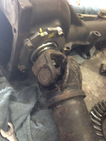

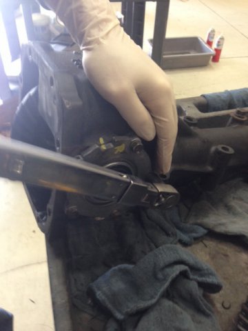

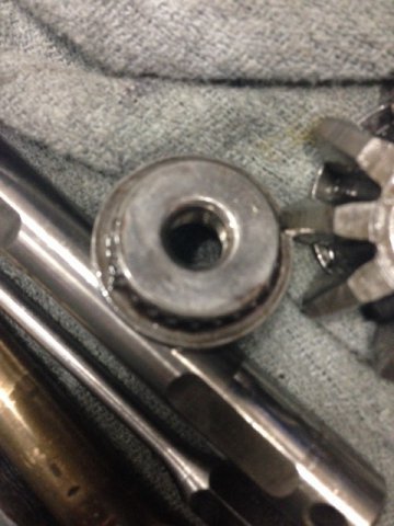

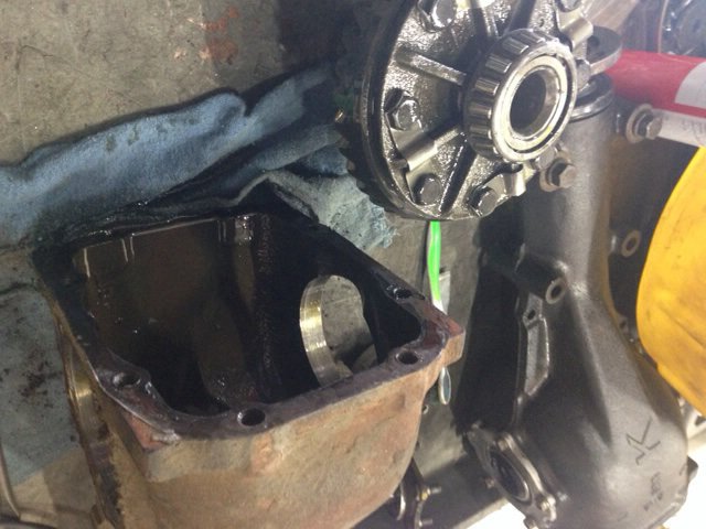

well......i'm really not happy and more frustrated than ever.........post-9962-0-18732000-1426561526_thumb.jpgpost-9962-0-60257800-1426561559_thumb.jpgpost-9962-0-65820300-1426561573_thumb.jpgpost-9962-0-21302900-1426561588_thumb.jpg
the receiver for the bolt-thru type axle shaft doesn't fit the spur gears on the R180 (from a 260z). I'm going to hope that a 260Z is different and pick up an r180 from a 240z.
i may have to put it all back together and deal with the diff. axle problems later.......i need to get it all back together and on the dyno........the diff. can be changed later..........

the 4.11 I bought is from a 720 4x4.
I've read through the procedure and leaving the buttons floating just doesn't seem right. There's no way to control end play.
With a combination of parts from the r180 and K R180 and some fabrication, I hope to have this differential working by the end of the day.....again...I hope!!!
so far looks good. Got the 240z axles to mate with the 720 4x4 diff. It's not a simple transfer or parts, or maybe I wasn't comfortable with letting the button float without some control of endplay.

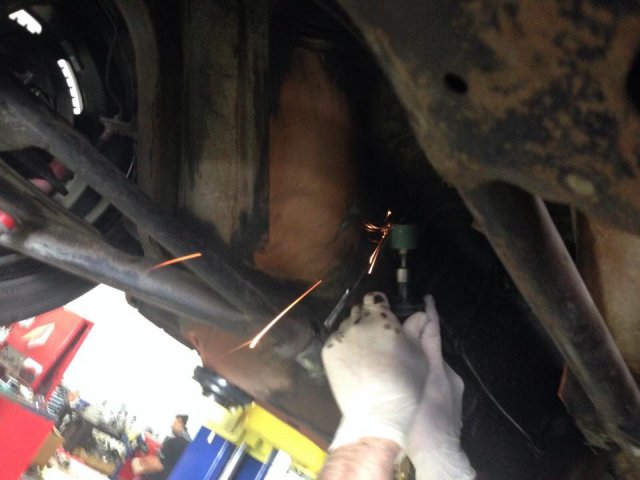

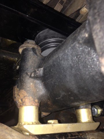

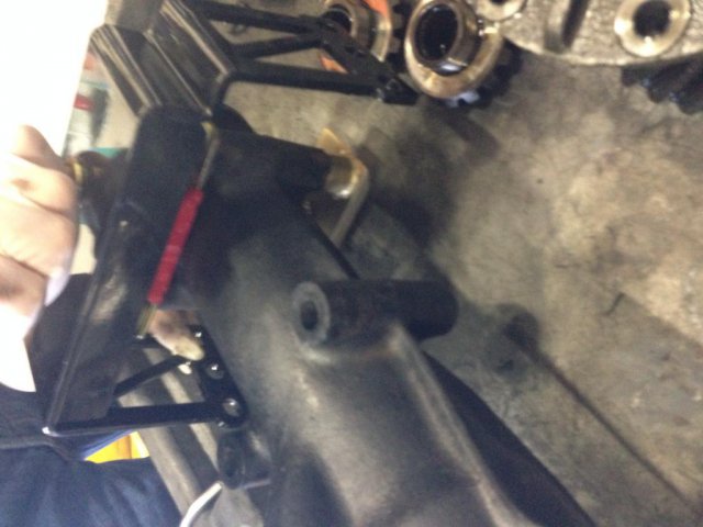

RT Mount- it didn't fit with the polyurethane mount on top. Going back to the first version of their mount and will trim to fit. Maybe it's because it's a 1970?
Yeah, there's a little bit of flange on the car that you have to trim off on the series 1 cars to get the RT mount to fit. But I'm not sure what RT mount you have, mine was made by a member here a couple years ago and was designed to fit any year S30.
I bought it from tecnoversion. It arrived quickly via usps.
We did trim off the flange, but you can only push the bracket up so far regardless....post-9962-0-68085200-1426643397_thumb.jpg
Back to the version #1

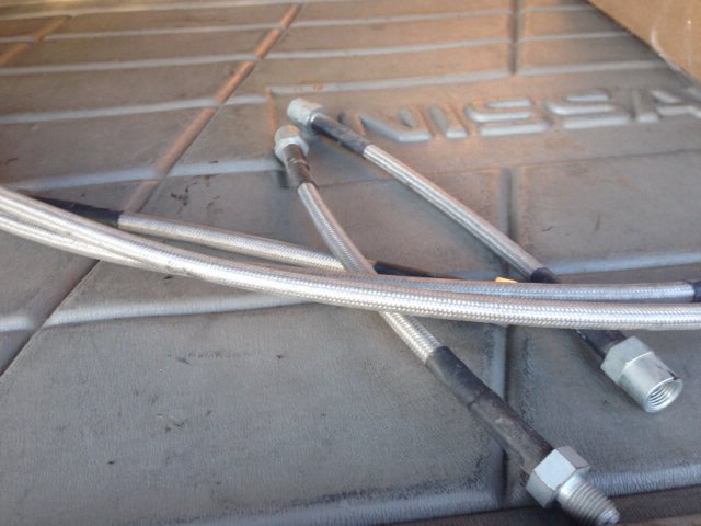

no big deal...brake lines...
maybe I should upgrade the front brakes at minimum???

When I installed mine, it was a pretty tight fit. Does it seem like it might go into place if you tapped on it a little (not hard)? Is it even close to fitting or way off? I got mine from Roostmonkey (member on here) FYI. Not sure if he still makes them or if he even browses here anymore.

moving up further will misalign the mount bolts, so it has to sit where it sits, there is no adjustability for the vertical position machined into the mount. The adjustment is done by trimming the bushing.
The 930 is very expensive, even near the price of a new GTR. It would be fun to swap out to programmable fuel injection, a turbo that isn't so laggy, 5 spd. conversion etc.....or maybe 993, which is still very expensive for a used car- that's Porsche for you, they retain value for certain. Z cars have also surprised me. I've seen nice ones sell for 20K+ and decent donor cars for 3500-5000.
Okay, I misunderstood the problem, I thought you were having trouble getting the RT mount itself bolted into place. I installed mine like your 'version 1' with a factory mount on bottom. If I'm remembering right, the RT mount was designed partly to improve driveline angles for a V8 swap when used with the poly mount you had (and without any mount on bottom), but I might be making that up. It's been a while since I did this and I'm foggy on details.
