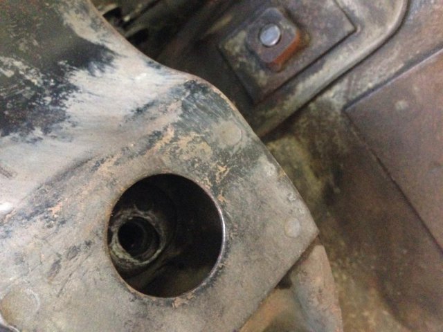

Hoover Posted March 18, 2015 Author Share Posted March 18, 2015 Okay, I misunderstood the problem, I thought you were having trouble getting the RT mount itself bolted into place. I installed mine like your 'version 1' with a factory mount on bottom. If I'm remembering right, the RT mount was designed partly to improve driveline angles for a V8 swap when used with the poly mount you had (and without any mount on bottom), but I might be making that up. It's been a while since I did this and I'm foggy on details. that's what I read as well. I'm not sure how the lower cross member would reinstall. It's over an 1" off. The way we mounted it works for us and wasn't overly difficult for a first-timer. Quote Link to comment Share on other sites More sharing options...

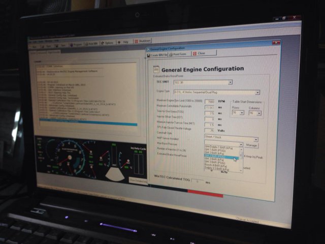

Hoover Posted March 18, 2015 Author Share Posted March 18, 2015 Since I have to wait... Will work on building a calibration for engine startup....Yes... I lost the original file... Quote Link to comment Share on other sites More sharing options...

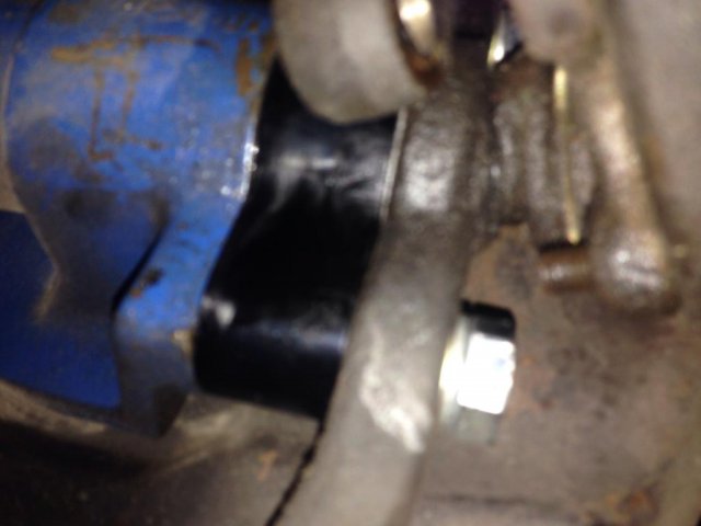

Hoover Posted March 18, 2015 Author Share Posted March 18, 2015 Bump Steer spacers Installed.... Tension control bushings are shot!!!!! Uhhhhgghhg!!!!!! Quote Link to comment Share on other sites More sharing options...
Hoover Posted March 19, 2015 Author Share Posted March 19, 2015 both t/c bushings are destroyed....not safe. brake lines are still soft, but old..... the more I look, the more I realize that it's an old car and even stored and under car cover, it needs some tlc. not comfortable with the brakes- big brake upgrade here I come....... Quote Link to comment Share on other sites More sharing options...

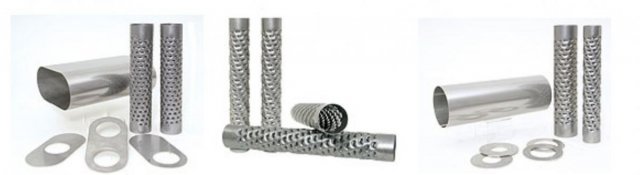

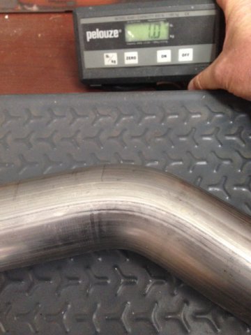

Hoover Posted March 19, 2015 Author Share Posted March 19, 2015 here' some of the materials ordered to build a lighter exhaust system. the mufflers should weigh 2.5lbs. each and tubing approximately 8lbs. my current exhaust isn't heavy, 27lbs., while the normal muffler shop exhaust weigh about 42+lbs. The new exhaust should be a net weight 13lbs. No doubt that it'll be louder, but I plan to build a chamber in the muffler to capture air before it flows out. Quote Link to comment Share on other sites More sharing options...

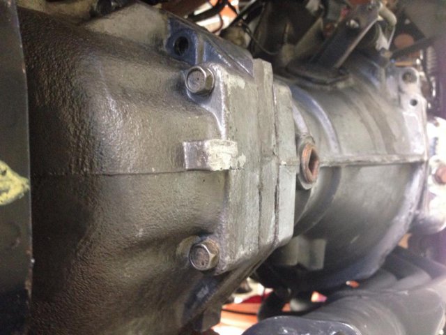

Hoover Posted March 19, 2015 Author Share Posted March 19, 2015 Trans. back in.... Quote Link to comment Share on other sites More sharing options...

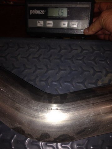

Hoover Posted March 19, 2015 Author Share Posted March 19, 2015 first lightweight materials have arrived. the difference is a 1/2 pound per foot of tubing. looks like i'll save 4.5 lbs. in tubing alone. Quote Link to comment Share on other sites More sharing options...
