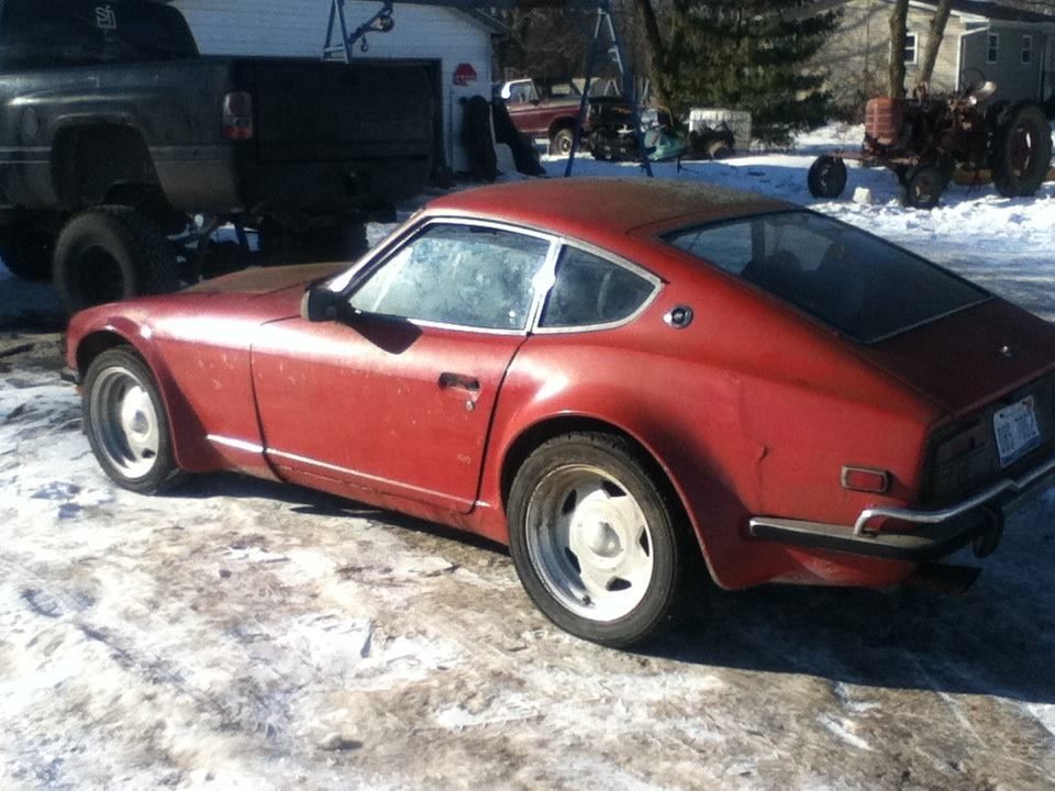

atcrider1 Posted March 6, 2015 Share Posted March 6, 2015 hey guys, im new to the forum and new to datsuns. i picked up a 72 240 with an l28 & 5 speed for $700, the car is running su's, an electronic mallory ditributor with a brand new module, low pressure electric fuel pump feeding the stock mechanical pump, all new fuel line, cleaned carbs. all of this stuff is new as i thought i had a fuel problem, put a different coil on last night, fired it up this morning and let it idle for 5-10 mins. when i tried to take off it started to sputter like its starving for fuel then died. itll fire right up after about 30 mins. any ideas? Quote Link to comment Share on other sites More sharing options...
