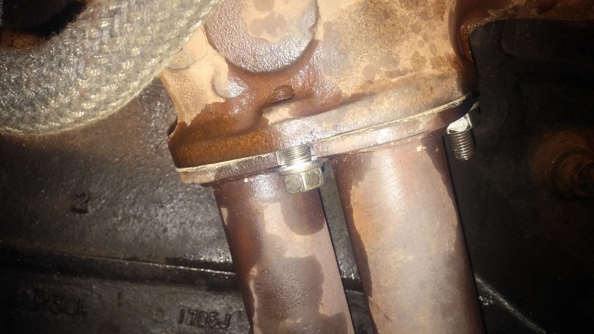

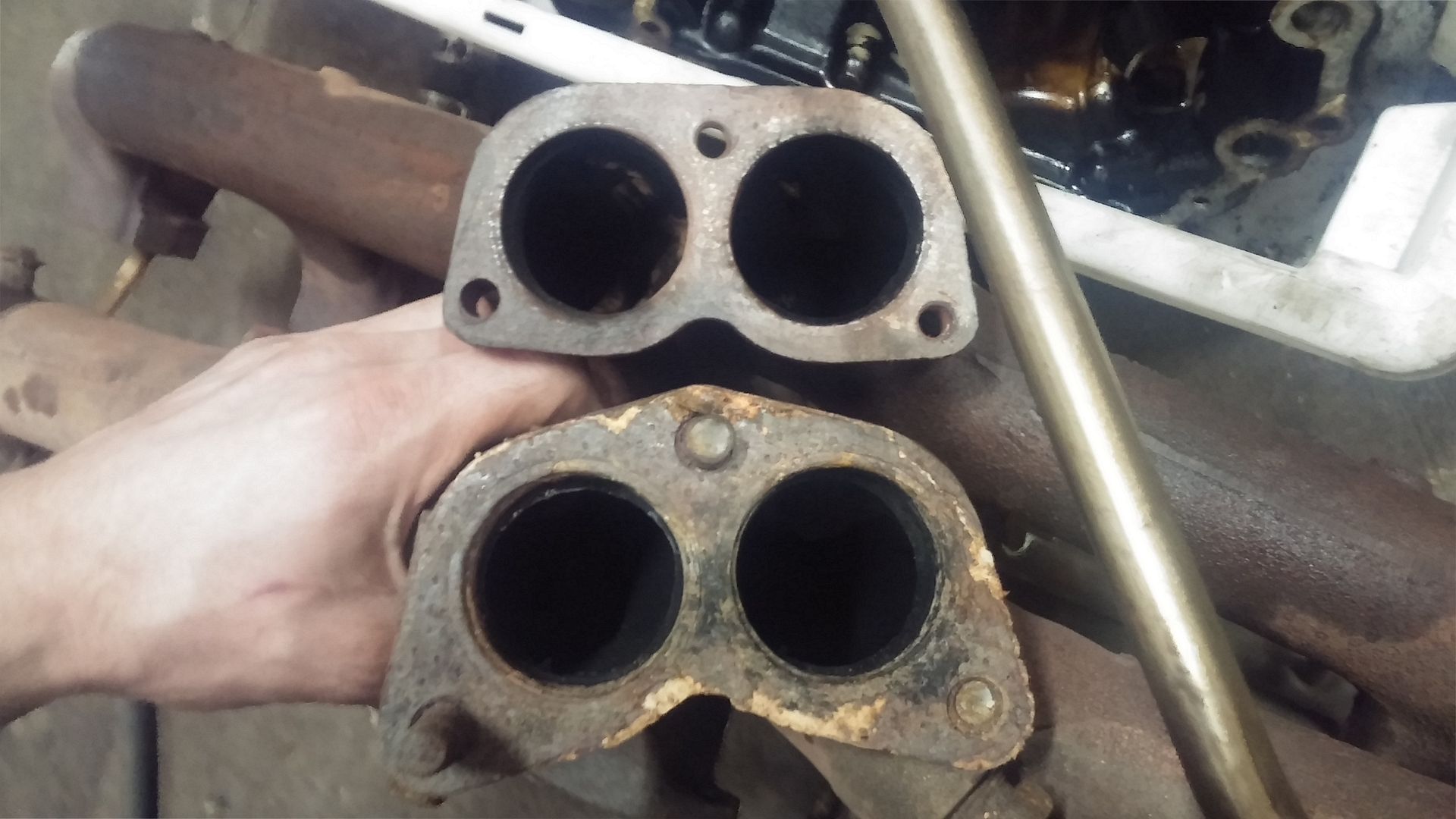

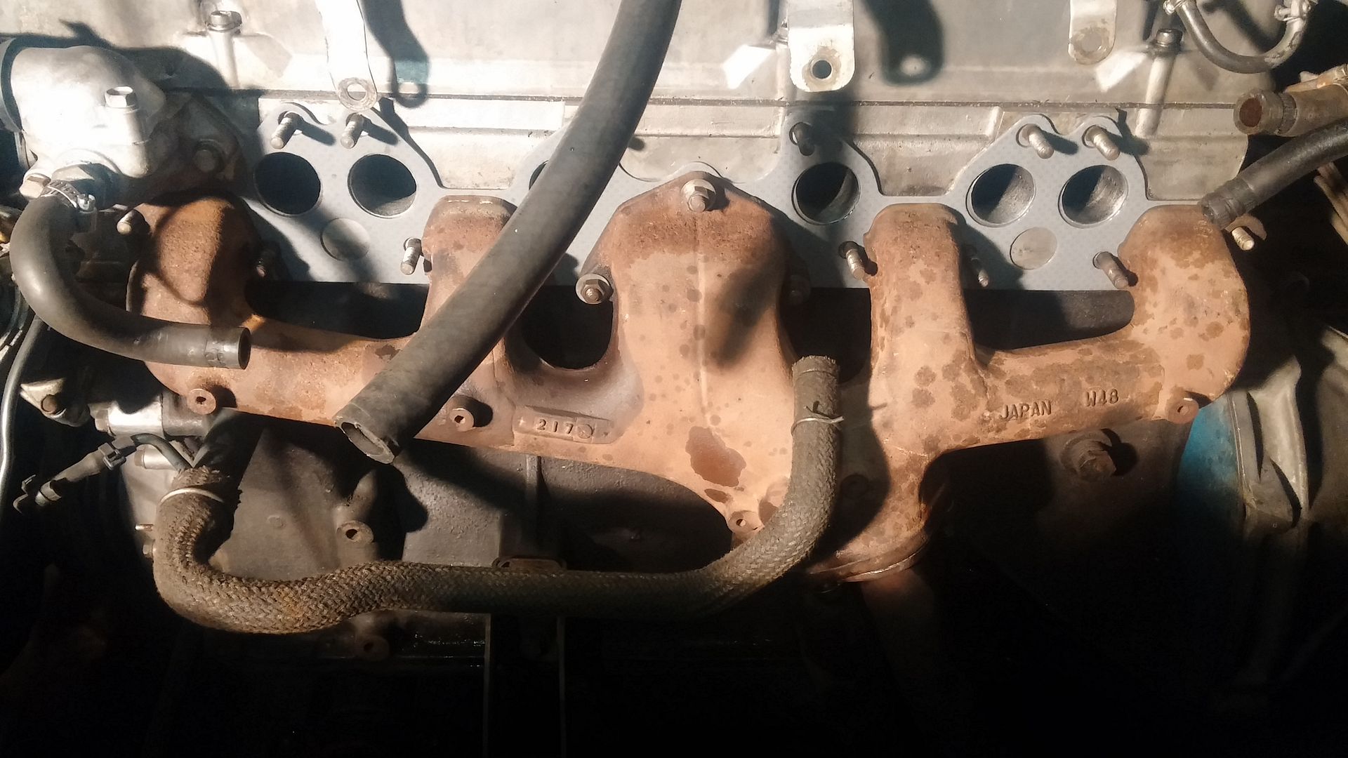

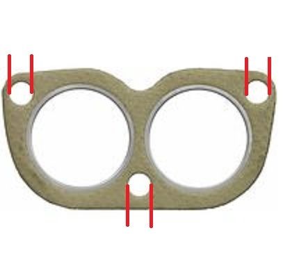

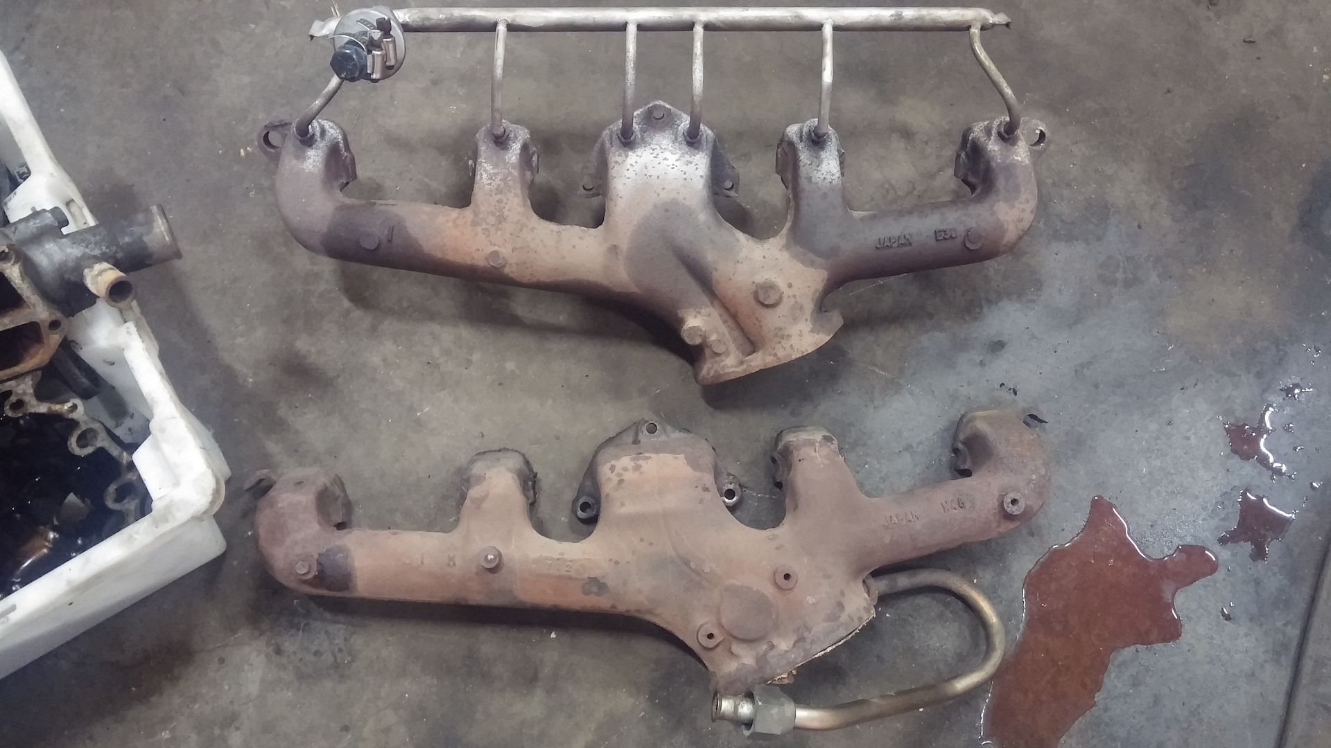

Tomzern 0 Posted March 24, 2015 Author Share Posted March 24, 2015 The later one is probably shorter from top to the collector flange. Take a measurement. It should fit the head but the exhaust pipes will be too far away, and and not aligned correctly. You'd need to do some pipe work. I did the swap yesterday and can confirm that the only difference between the stock 1970 240Z smog manifold and the W48 manifold is the bolt pattern on the outlet flange. Since I didn't find any info on this subject myself, I might as well make a little guide now if anyone else wants to do this Here is a couple of comparison pics of the two types: Stock on top, W48 bottom The W48 manifold has larger runners compared to the stock one. Don't know you gain anything out of it though. So here is how I solved it. on the W48 manifold the bolts on the outlet flange are 10mm instead of 8mm that the stock one uses. They are also placed further out from the outlet holes, but the pattern and size of the exhaust outlet holes are exactly the same as the stock manifold. I took of the collector pipe and cut the bolt holes out with an angle grinder to allow it to fit the new manifold. Then I mounted it in place and it all fit perfectly! I forgot to take pictures of the modified collector pipe, so here is a quick drawing that shows where to cut: It doesn't look pretty, but it's a cheap and easy way to get rid of the smog manifold Quote Link to post Share on other sites

NewZed 85 Posted March 24, 2015 Share Posted March 24, 2015 Interesting. I would think that the 80's Maxima would use something like the 80's ZX's. I thought that it would look like this F54 manifold (right), compared to a 280Z N42 manifold. Good to know. Quote Link to post Share on other sites
