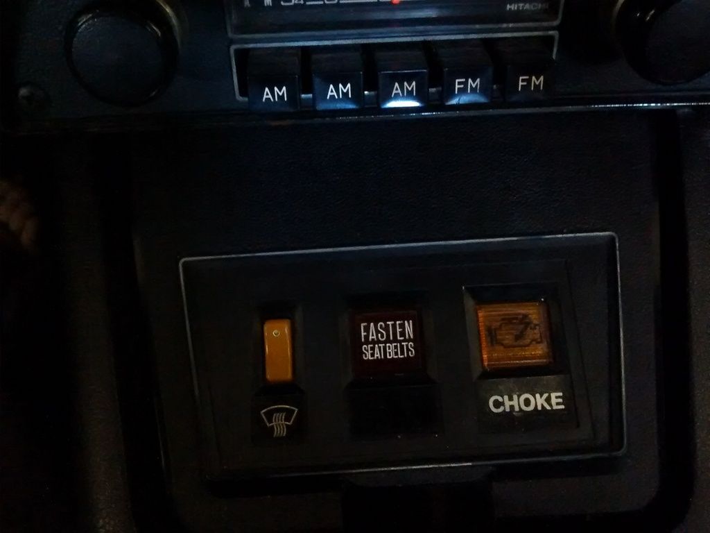

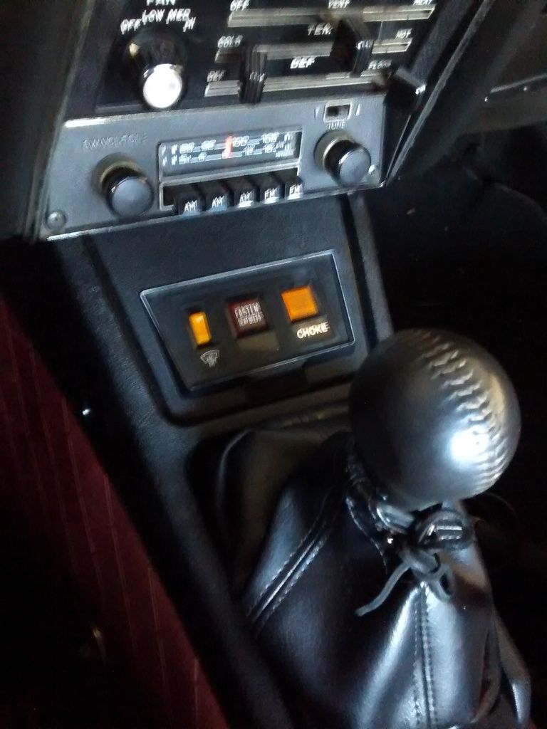

crapforum Posted May 24, 2015 Author Share Posted May 24, 2015 Well exhaust leak sorted out for now, the engine revs much better now and it seems to have gained even more horsepower, seems proper O2 readings are very important on these new engines. Also found a place to wire my check engine light to: Seeing as how I no longer have a choke I soldered the check engine wire from the ECM onto that bulb. Illuminates nicely and required no extra wires or modifications to the stock interior. Quote Link to comment Share on other sites More sharing options...
RebekahsZ Posted May 25, 2015 Share Posted May 25, 2015 Goodness, why do you want a check engine light? Mine wears me out in the truck! Quote Link to comment Share on other sites More sharing options...
crapforum Posted May 25, 2015 Author Share Posted May 25, 2015 Goodness, why do you want a check engine light? Mine wears me out in the truck! Haha I got tired of seeing a code pop up when tuning the motor with my laptop saying "check engine light failure" so I added one. Added a sticker to make it more check engine like Quote Link to comment Share on other sites More sharing options...

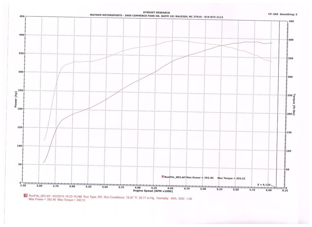

crapforum Posted June 2, 2015 Author Share Posted June 2, 2015 (edited) Got a little bit of dyno tuning, it had a baseline of 374hp and 374tq, ended up with 392.4hp 392.51tq with that 20 extra showing up throughout the whole powerband as well as the power coming in a little quicker on the bottom end. So somewhere around the 480hp at the motor, I'm happy for now All this on some 87 octane and 9.6:1 compression. Edited June 2, 2015 by crapforum Quote Link to comment Share on other sites More sharing options...
