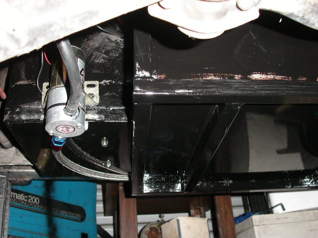

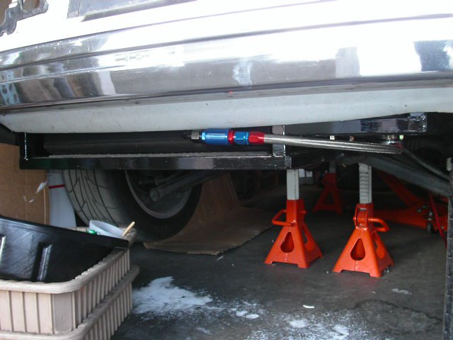

12doplumbing Posted April 2, 2015 Share Posted April 2, 2015 My son and I cut out the spare tire well and mounted a 15 gallon fuel cell underneath: We want to mount the pump right alongside the cell underneath. Anyone have pictures of a similar set up? Or thread suggestions? We'll be using the same filler location as factory via a new filler neck, etc.; welding a new cover over hole with a chase for filler neck. Any suggestions on fuel pump for turbo engine? Basic reliable pump sufficient for the system? Also, was planning on going with Fatts Rollover tubing schematic you find on Ratsuns http://www.pirate4x4.com/forum/general-4x4-discussion/243815-fats-fuel-air-trap-system.html#post2712471 and abandoning / removing canister from above and all the factory hose routings. Any thoughts? New filler neck comes with breather, and with rollover system planned, what other item should I be concerned with? I have new 3/8 feed and return rigid tubing plumbed through tunnel... Link to comment Share on other sites More sharing options...

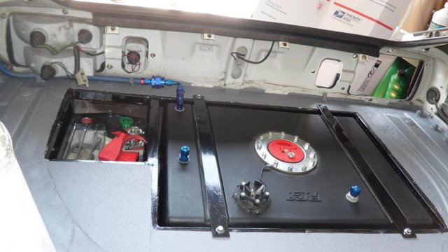

ritrebor Posted May 6, 2016 Share Posted May 6, 2016 Here's my set up. ritrebor. Link to comment Share on other sites More sharing options...
madkaw Posted May 6, 2016 Share Posted May 6, 2016 Right now I run a CJ-5 tank in the same location. I didn't need a fuel cell since I'm not racing mine. It is a plastic tank with metal cage. I also wanted to keep the fill point at stock location. Don't want fuel in my hatch. Getting ready to convert to FI and might change out my tank for a fully baffled steel one from Tank.inc . They also sell tanks with various filler necks to keep stock fueling. As far as fuel pump, just ordered a Delco OEM pump for a F-150. External pump with OEM reliability . Fuel inc. sells the tank with Walbro pump for about 400$ Link to comment Share on other sites More sharing options...
CRAracer05 Posted May 7, 2016 Share Posted May 7, 2016 On 5/6/2016 at 4:46 AM, ritrebor said: Here's my set up. ritrebor. What size fuel cell, and it looks like you added your sending unit possibly? Link to comment Share on other sites More sharing options...
ritrebor Posted May 10, 2016 Share Posted May 10, 2016 It's a 16 gal cell with foam inside. Sending unit works a for a chevy autometer guage. ritrebor Link to comment Share on other sites More sharing options...
