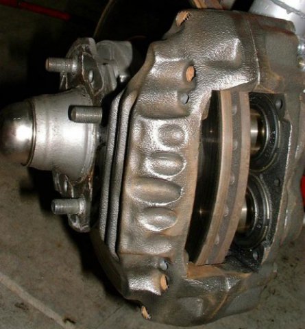

New-to-240z Posted April 28, 2015 Author Share Posted April 28, 2015 These aren't my calipers, but they will do Basically, where the rotors slot into the caliper body, one side of the slot touches the rotor. I just ground down a small amount of material off the caliper slot face. the rotor spins freely now but it sits closer to the face that I ground down then the other side of the slot. Quote Link to comment Share on other sites More sharing options...
Miles Posted April 28, 2015 Share Posted April 28, 2015 (edited) Is there some reason that you can not take a picture of the caliper mounted on the car that shows specifically the rotor contacting the caliper? Otherwise this is just a guessing game. The attached picture shows a S12W Toyota caliper and 300ZX rotor installed on a Z. Does your caliper and rotor look like the picture? Edited April 28, 2015 by Miles Quote Link to comment Share on other sites More sharing options...

New-to-240z Posted April 29, 2015 Author Share Posted April 29, 2015 Here you can see the clearance of the rotor to the caliper sides. This was after making the necessary grinding. Everything fits without problem now, and the grinding really was minimal. Nothing is ever 100% perfect on these old cars. So, what do you think? Any issues? @Six_Shooter : That was my thought too. The piston on the side that may have to travel a tiny bit more will just have to extend out further on the first brake push. But after that, it shouldn't have any problem and should be equal pressure on both sizes. Quote Link to comment Share on other sites More sharing options...
