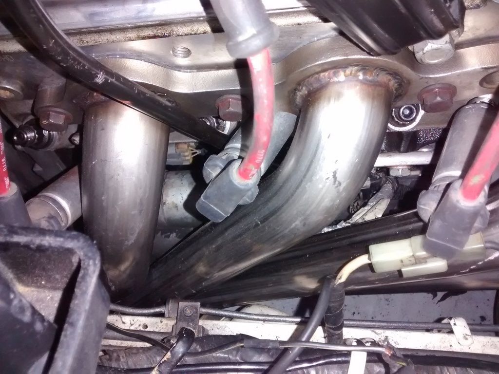

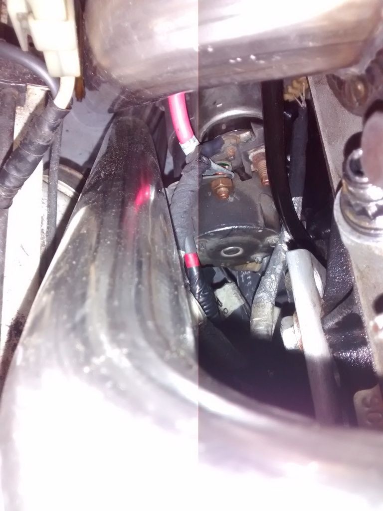

crapforum Posted April 20, 2015 Author Share Posted April 20, 2015 Thanks for all the recommendations, I went and ran the positive over top of the starter, seems it will do okay. The issue was that if I have the battery cable going straight up and over the starter then the metal foot on the cable end would be very close to the pin on the starter that tells the starter solenoid to kick on. I had to bend the metal foot to point sideways to keep it clear from that solenoid pin, but this places it towards the header. I'll post a picture later today. My battery sits in the back of the car so no issues there. I use the Taylor 10mm plug wires. My MSD wires always cooked and came apart real fast even when using the sleeves. I know exactly what you mean with the MSD wires, I HATE THEM. I had them on my 78 Camaro and even with plug boots they would melt, I blame myself for buying into the heavy advertising MSD does. I went with Taylor plugs as well and they were excellent. Quote Link to comment Share on other sites More sharing options...

crapforum Posted April 21, 2015 Author Share Posted April 21, 2015 (edited) Those are only 1 5/8 primary tube headers correct? Supposed to be 1.65" which is a tiny bit larger than 1 5/8 I too looked at the CRX Racing setup and decided against it. As you are experiencing now clearance is a real problem with their kit. The JCI kit has some tight tolerances also especially for us using the Sanderson headers. Living in California, JCI headers are unavailable to us, which are a much better fit. You've come this far using their products so congrats to you. On your build, move your brake line(Passanger side) to the top of tthe frame rail and back towards the fender as far as possible. Take your time it will move for you! Get it away from your bare headers. Also Summit Racing sells a flexible oil dip stick for our LS1 engines, its Lokar ED-5008. Anyway, good luck with the Build and enjoy the Ride! Yeah I will have to move that brake line, but the stock truck dipstick did fit just fine! Below you can see the clearances I was talking about, I will probably buy a heat reflective starter blanket as added protection. Hopefully the MSD wires are more heat resistant now, the ones I had that were melting were about 7 years ago! Edited April 21, 2015 by crapforum Quote Link to comment Share on other sites More sharing options...

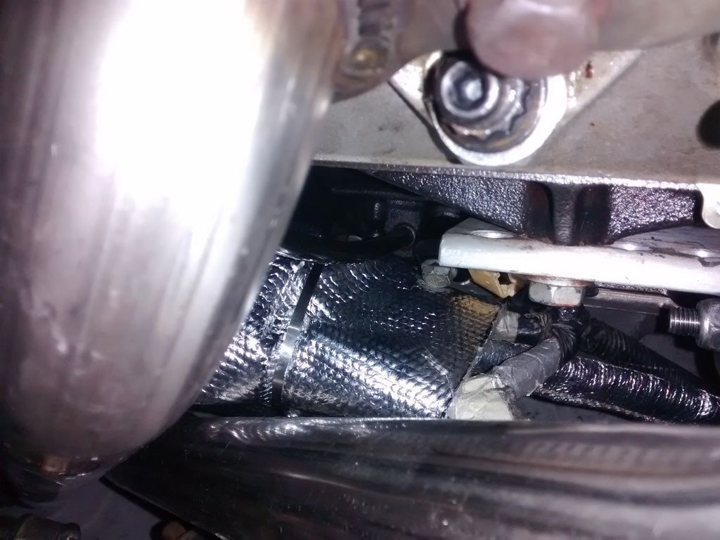

crapforum Posted April 26, 2015 Author Share Posted April 26, 2015 Wanted to update and say that I have my wires how I think they will last. Have the power going over top the starter and then power going out from the started to the front of the motor and across. Had to bend the terminals for the power cables at 90* to make them route good. Wrapped them in insulator sleeves and then wrapped the started in a insulator blanket. Both are some sorta fiberglass weave with aluminized outside. Quote Link to comment Share on other sites More sharing options...
