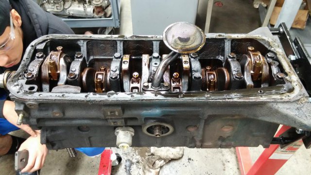

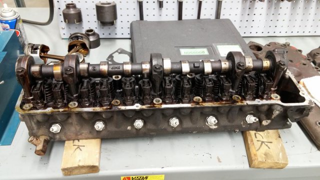

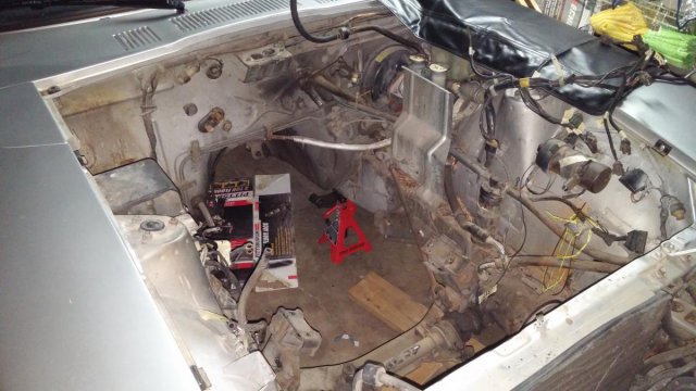

So I recently purchased a 1978 280Z from the original owner.  The car ran but the water pump was bad and the owner broke 2 of the bolts when trying to replace it.  The car started up perfectly every time and shifted fine so I took it as is.  The paint was in great condition and I found very little rust.  A couple of weeks ago I pulled the motor and last night took the head off.  Haven't taken apart the head or block but everything seems to be in really good shape.  Besides the broken bolts plus the one I broke taking off the thermostat housing since it was so corroded.

Very little machine work as I heard the N47 exhaust port should not be messed with.  Maybe just some slight work on the intake port for better flow.  A little unshrouding

If ti started and ran fine, it probably was fine.  Might be best to just get a new HG and put it back together.  The stock Datsun parts are of high quality, even used, compared to much of the "rebuild" parts you'll find.  A bore means all new pistons and rings, for no real benefit.  A hone means new rings, for what, if it ran fine?

I would add to get a 5-spd out of an 82/83 280ZX as it has the best set of gear ratios in it to go with the 3.90:1 R200.  The others will work but won't be as optimal.  The other thing you might consider is the head and cam out of an 82/83ZX since you already have yours off.  They had a broader torque range than what you have in your 280Z. Not sure about the exhaust ports matching though.  Been a very long time since I last looked at that.

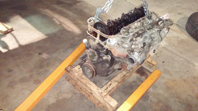

Just picked up an L28ET out of an 82ZX.  Going to drop this into my 78Z instead of the original motor.
