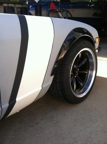

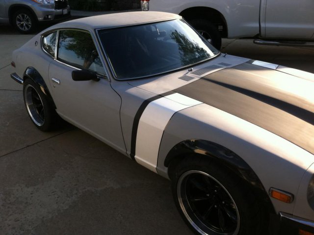

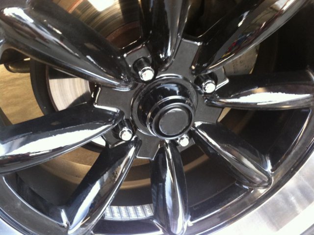

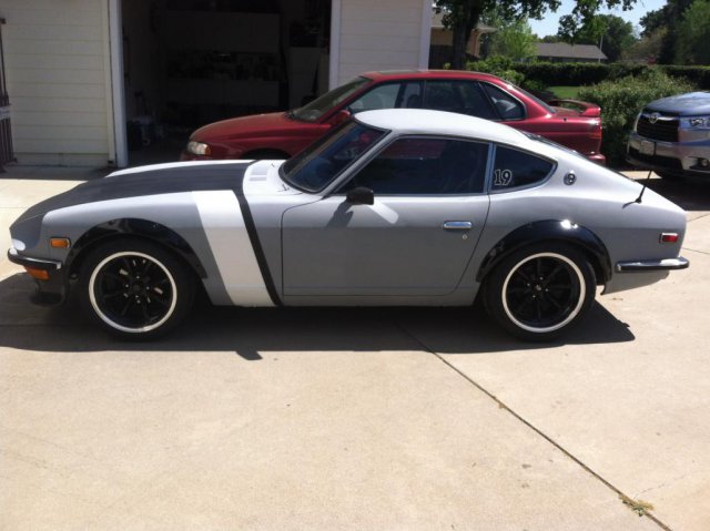

trackzpeed Posted April 4, 2016 Author Share Posted April 4, 2016 Put the car back in primer after some recent body work..... primer is fun to play with, this in the new paint scheme I'm toying with. Also included a shot of the center cap up front.... they wont fit unless you modify them a bit with a hole saw. Not perfect but still cleaner than nothing at all.. Jim Quote Link to comment Share on other sites More sharing options...
Stock Car Mafia Posted April 4, 2016 Share Posted April 4, 2016 From my experience-take those HPS back and get your money back. Worse pads than bottom shelf AutoZone. They are made to last a long time (the S is for street) or (shit). They had ZERO bite on my car and I couldn't freakin' stop. Get one of Hawks race pads. Porterfield R4 or R4S stop well, but are VERY dusty. Especially the R4. Very helpful post Keith! I will proceed as indicated. Jim, that car is looking fantastic! Keep the updates coming. Quote Link to comment Share on other sites More sharing options...

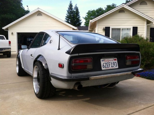

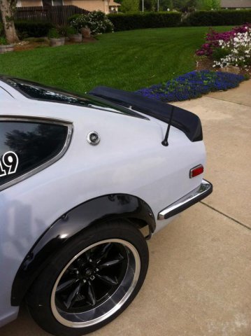

trackzpeed Posted April 9, 2016 Author Share Posted April 9, 2016 BRE spoiler on....... I like it. Nice fit and finish too. Quote Link to comment Share on other sites More sharing options...
RebekahsZ Posted April 9, 2016 Share Posted April 9, 2016 Looks great! Quote Link to comment Share on other sites More sharing options...

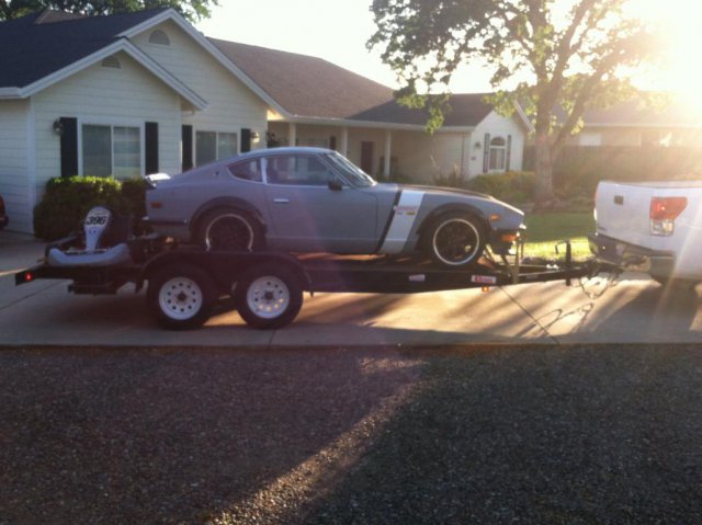

trackzpeed Posted April 19, 2016 Author Share Posted April 19, 2016 Off to the AutoX races with my daughter and her kart...... finished 2nd in my class and I only made one run. Lost the fuel pump when it starved a bit then burned up, bummer. I'm now on my third pump (on the way), and going to drop it down 2 inches to take advantage of the gravity flow. Kinda sucks..... if I did it again I'd find a way to go internal pump in tank where the fuel can keep her cool. Updates to follow. Oh yea, My daugther took second too but she ran against 7 cars in the novice class since no other karts showed that day. She is only 12 but eyeballing the Z every race, we may have to share in a few years LOL. Quote Link to comment Share on other sites More sharing options...
