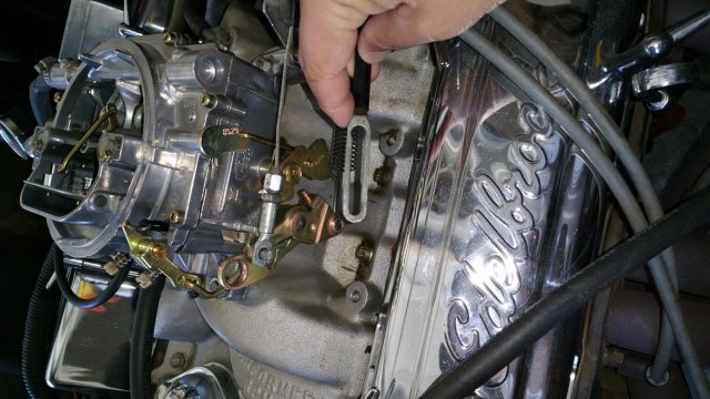

NinjaWa Posted May 5, 2015 Share Posted May 5, 2015 I bought the Z with the 350 in already and not really familiar with the motor, so I was wondering can somebody tell me where this goes? Quote Link to comment Share on other sites More sharing options...
Scarab 155 Posted May 5, 2015 Share Posted May 5, 2015 That is the transmission kick down cable. for an automatic trans. It links to the carb linkage pivots. What transmission is in the car ? Quote Link to comment Share on other sites More sharing options...
NinjaWa Posted May 5, 2015 Author Share Posted May 5, 2015 That is the transmission kick down cable. for an automatic trans. It links to the carb linkage pivots. What transmission is in the car ?Turbo 350 Quote Link to comment Share on other sites More sharing options...
jhm Posted May 5, 2015 Share Posted May 5, 2015 After selecting an appropriate connection point on the carb linkage, the kickdown cable can be adjusted to your individual driving style and performance needs. Quote Link to comment Share on other sites More sharing options...
NinjaWa Posted May 6, 2015 Author Share Posted May 6, 2015 thanks guys i appreciate the help Quote Link to comment Share on other sites More sharing options...
jhm Posted May 6, 2015 Share Posted May 6, 2015 For what it's worth, when I had a TH350 in my car, I had the kickdown cable connected to the carb linkage on the lower mounting point (where your throttle return spring is currently hooked to.) If you decide to use this mounting point, you can actually rehook your return spring(s) to the kickdown cable if you want. Attached is an old pic of my engine bay, and if you zoom the photo, you can see how the cable is hooked up. Hope this helps... Quote Link to comment Share on other sites More sharing options...
