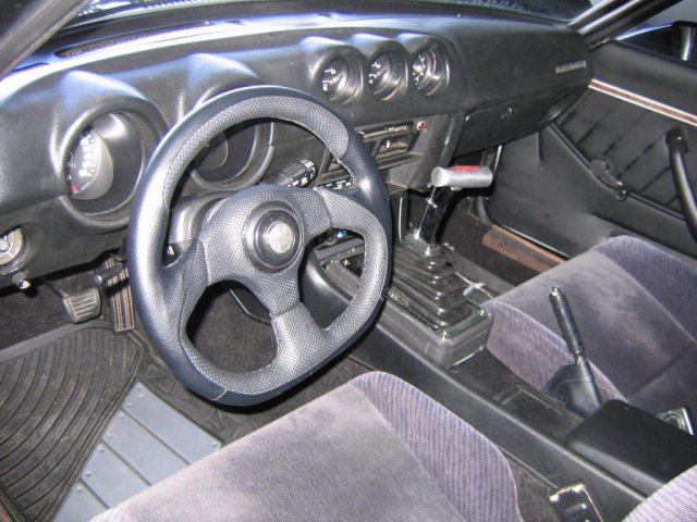

jhm Posted May 11, 2015 Share Posted May 11, 2015 B&M Mega-Shifter on my 200-4R. For non-OEM, B&M seems to be an industry standard for auto shifters....very beefy construction and easily adapted to wide variety of applications. A lot of people do away with the center console completely, but it's certainly not necessary. Sorry I don't have a better picture. Quote Link to comment Share on other sites More sharing options...
VSnakeByteV Posted May 11, 2015 Author Share Posted May 11, 2015 Awesome, thanks for the picture! How difficult was the install? I would also like to keep the center console. Which shifter is that one specifically? Quote Link to comment Share on other sites More sharing options...
jhm Posted May 12, 2015 Share Posted May 12, 2015 B&M Mega-Shifter 80690 (I think. It was a few years ago.) Pretty easy install, using some flat plate for mounting surface in the stock shifter mounting location. Had to do some minor trimming on the center console and the shifter base. I like the ratchet action and reverse lockout, and it's compatible with 3- and 4-speed autos. Quote Link to comment Share on other sites More sharing options...

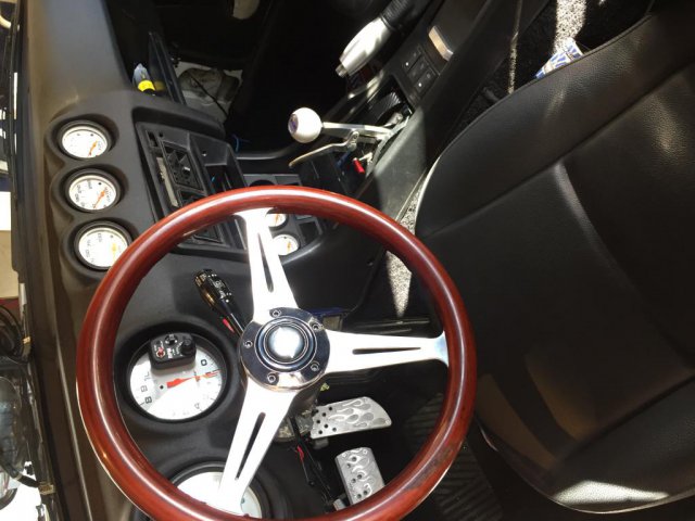

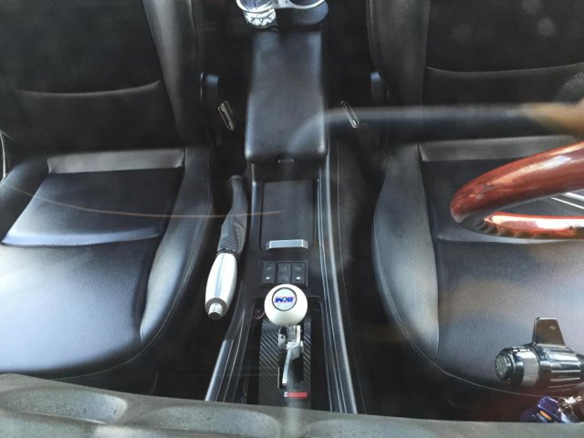

ritrebor Posted May 12, 2015 Share Posted May 12, 2015 Here's mine. B&M Pro Stick Sunk it a few inches in the hump so it would not be high and I could use my console. ritrebor Quote Link to comment Share on other sites More sharing options...

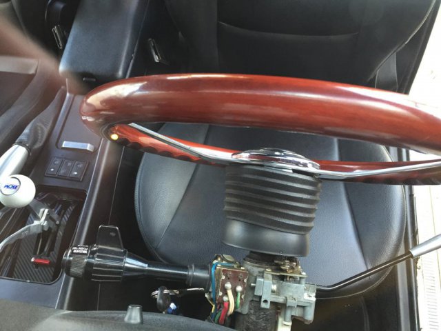

VSnakeByteV Posted May 12, 2015 Author Share Posted May 12, 2015 Thanks for the info. Ritrebor thanks for the pics, would you mind posting one of an angle from the drivers seat? Dude your ash tray cover is awesome, who makes it? Thanks again for the pics. Quote Link to comment Share on other sites More sharing options...
lunchy23 Posted May 17, 2015 Share Posted May 17, 2015 Ppp shifters the best Quote Link to comment Share on other sites More sharing options...
ritrebor Posted May 19, 2015 Share Posted May 19, 2015 Go t the ash tray piece here on a group buy a while ago. ritrebor Quote Link to comment Share on other sites More sharing options...

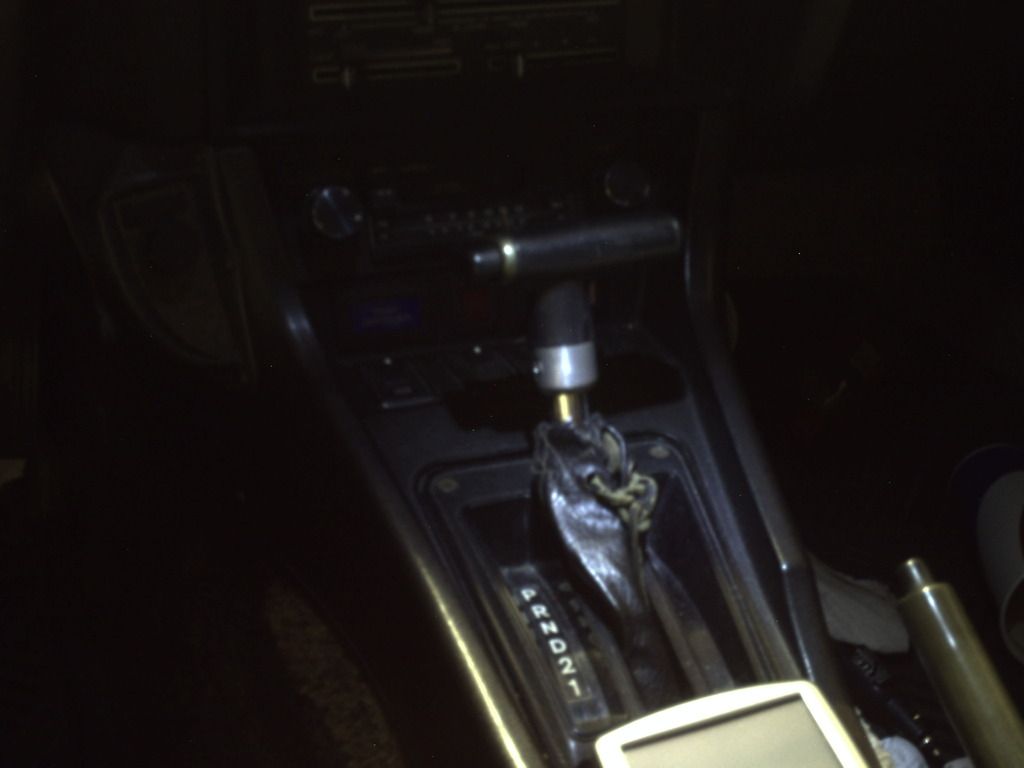

720fast Posted May 19, 2015 Share Posted May 19, 2015 I have the Datsun shifter with my 700r4. Quote Link to comment Share on other sites More sharing options...
VSnakeByteV Posted May 19, 2015 Author Share Posted May 19, 2015 Wow looking good. I'll have to see if I can get one of those ash tray covers. Thanks! 720fast - is that a stock auto insert for the car? Quote Link to comment Share on other sites More sharing options...
