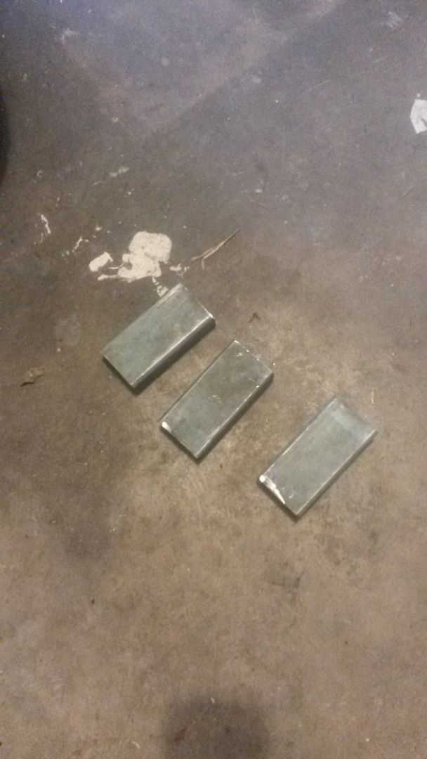

Drift Boss Posted May 17, 2015 Author Share Posted May 17, 2015 Next up is welding my floor to support the trans mount proper. Today I pulled a whole 240sx throttle cable set up. I even drilled out the pedal support. So I should be able to bolt it all in where I want it. Quote Link to comment Share on other sites More sharing options...

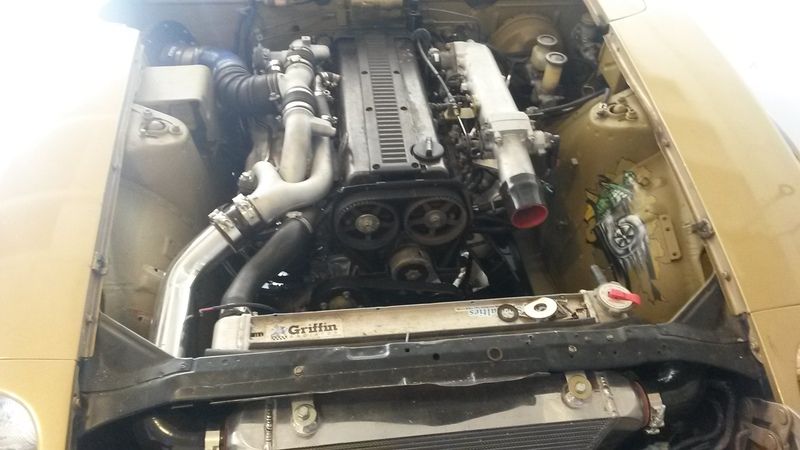

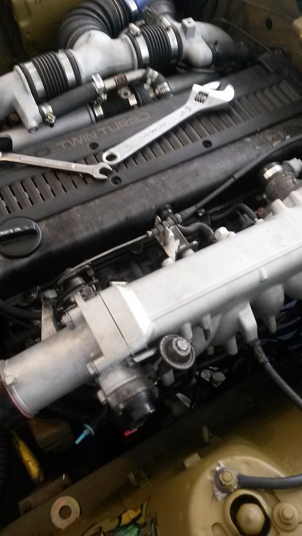

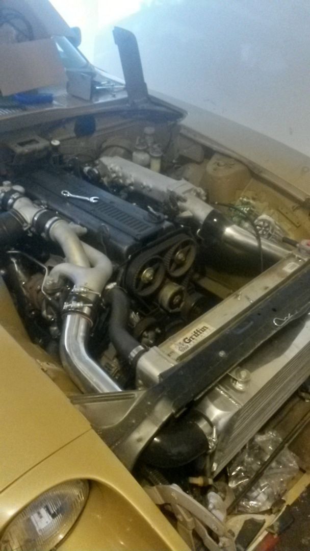

Furio Posted May 21, 2015 Share Posted May 21, 2015 (edited) Looks great man! Will be taking notes as I'm about to start my 1JZ swap as well haha. Also got my wiring kit from WS, will be interesting to see how they do. Out of curiosity where did you get the A: Top mount kit and B: Downpipe? I'm guessing CXRacing for the top mount, looks like one of their kits. Edited May 21, 2015 by Furio Quote Link to comment Share on other sites More sharing options...
Drift Boss Posted May 21, 2015 Author Share Posted May 21, 2015 Downpipe drift motion. Manifold cxracing =) Quote Link to comment Share on other sites More sharing options...

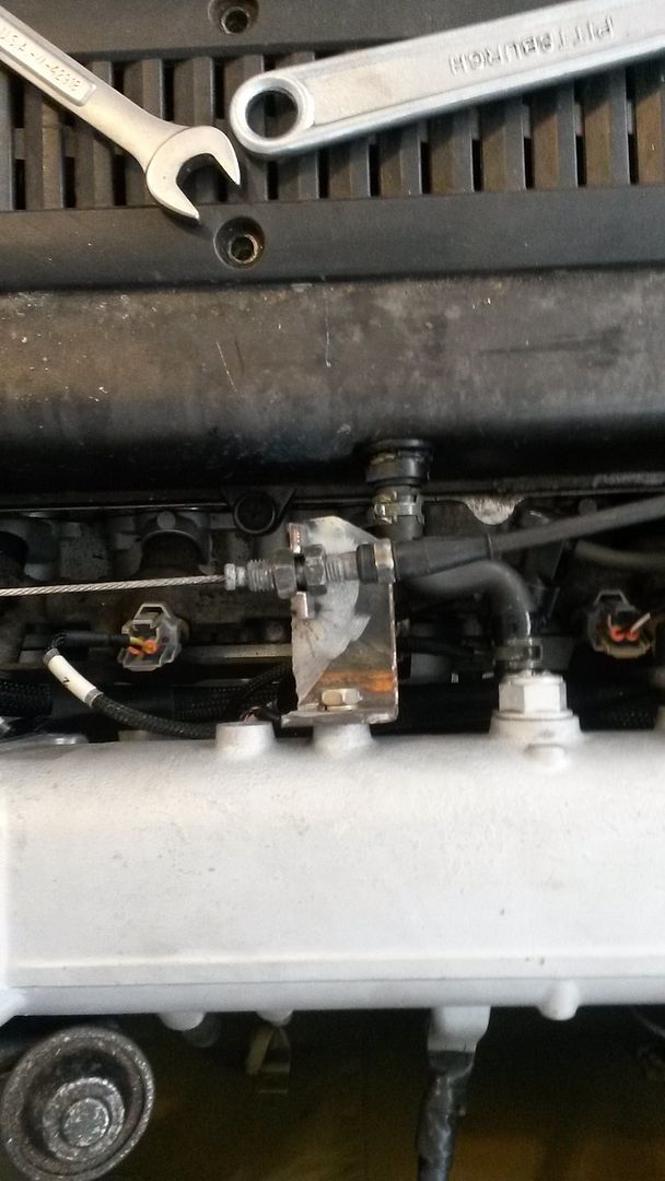

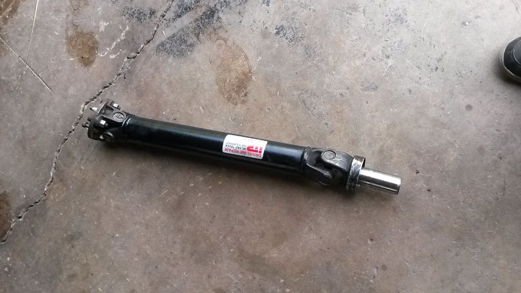

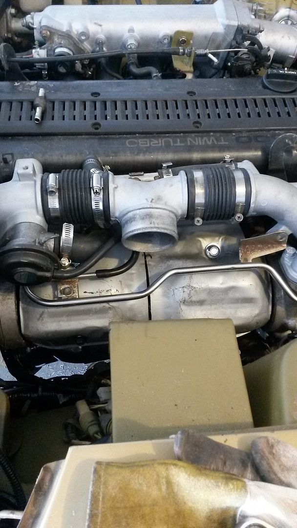

Drift Boss Posted May 24, 2015 Author Share Posted May 24, 2015 Hopefully this will hold. We will see. I just used what I had at my disposal. I am no fabricater by all means. I measured the drive shaft length to 37 3/4. Not bad. I will be using the stock supra drive shaft, and my stock z shaft. I am taking them to a local driveshaft shop to be made together. Next is to tackle the throttle cable,which is another can of shit to figure out. I got a nissan 240sx whole throttle system, hopefully I can make that work. H Quote Link to comment Share on other sites More sharing options...
Drift Boss Posted May 29, 2015 Author Share Posted May 29, 2015 Anybody have ideas on throttle cable? I pulled everything from a 240sx in hopes it might work some how. Also..I ordered a 1990 toyota supra 5 speed clutch line, bolts right into the oem 280z clutch line! If anyone has a 1jzgte rear sump oil dip stick assembly, I need it. Also a junk speed sensor. I just need it to plug the hole. Quote Link to comment Share on other sites More sharing options...
Drift Boss Posted May 29, 2015 Author Share Posted May 29, 2015 Oh, and I had a driveshaft made. =) Thanks Quote Link to comment Share on other sites More sharing options...

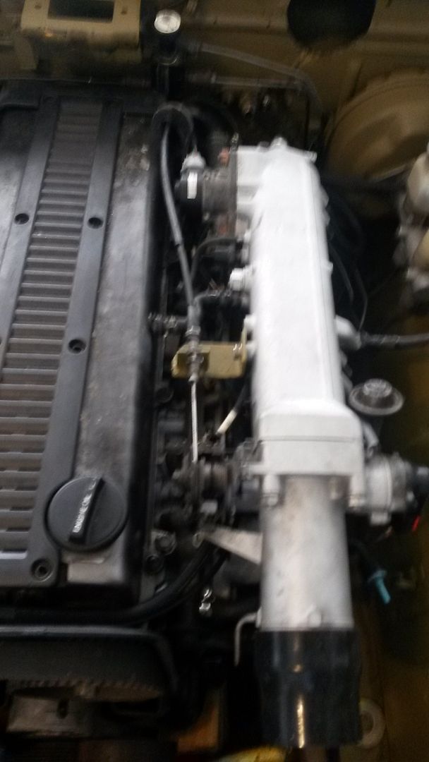

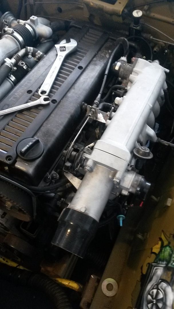

Drift Boss Posted June 24, 2015 Author Share Posted June 24, 2015 I modified the 240sx upper throttle pedal to the lower 280z throttle pedal. Then I made a simple bracket. Quote Link to comment Share on other sites More sharing options...

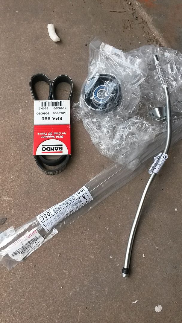

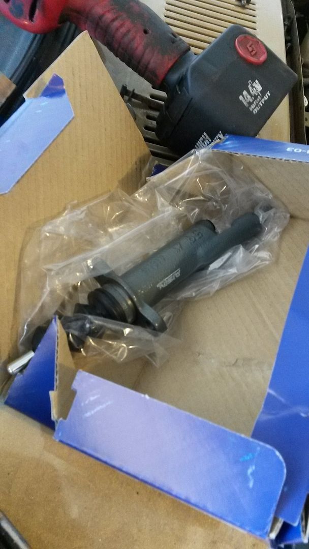

Drift Boss Posted June 26, 2015 Author Share Posted June 26, 2015 Put in the head sheild to protect my datsuns wire harness. I just cut it to fit. Then I got in my 1990 supra clutch Slave cylinder. Bolted right up. I am glad I don't have to fight that like the gas pedal. I used a 1990 supra steel Braided Clutch line, went right on to the datsuns hardline. Installed a Walbro 255 in line pump. Starts right up and revs! =) Here is a video. And next is my order from drift motion. A serpentine ac/ps delete kit, and a rear mounted oil dip stick. N Quote Link to comment Share on other sites More sharing options...

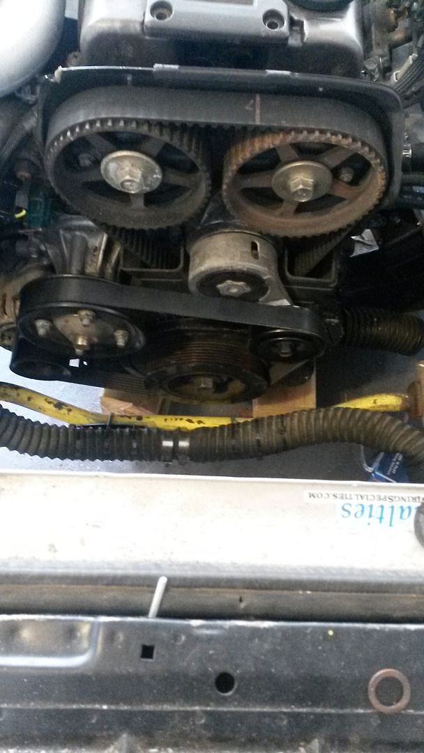

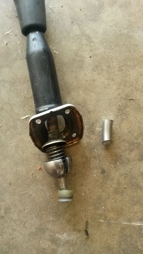

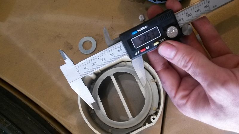

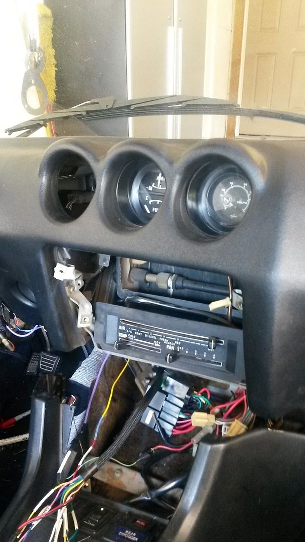

Drift Boss Posted June 30, 2015 Author Share Posted June 30, 2015 Got my dash gauge out. Wasn't to bad. I measured I can install a 52mm or 2 1/16 gauges. I ordered some auto meter ones. I ordered water and boost. (Plan on getting tach, fuel, and rpm later) Do you guys remove the oem plastic clear or leave it? Got the "s2000" pulley mod from drift motion installed. Shorten up the shifter and got it all straight rather then bent. ....still waiting for one coupler to show up... N Quote Link to comment Share on other sites More sharing options...
