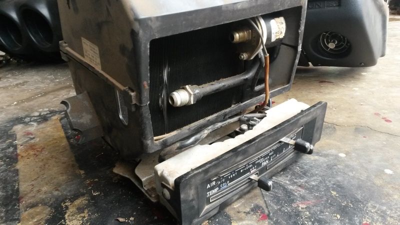

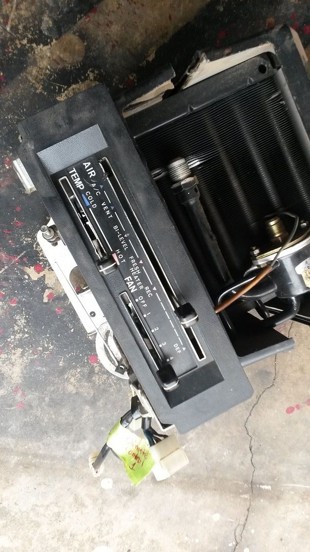

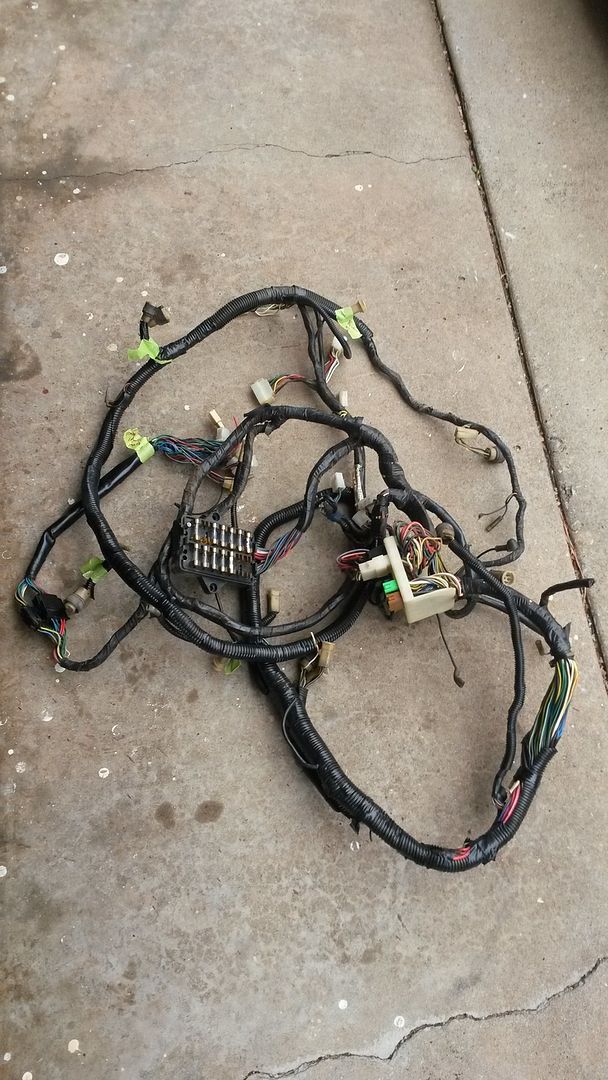

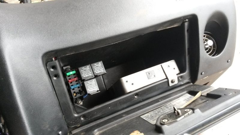

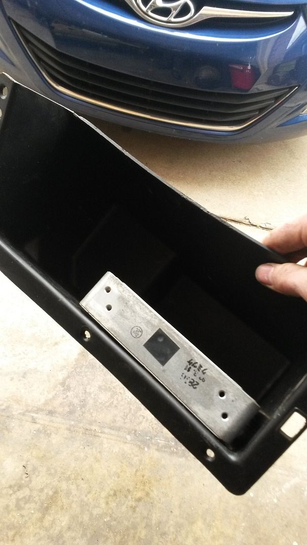

Drift Boss Posted December 20, 2015 Author Share Posted December 20, 2015 The start. Don't need this shit. It's for sale if anyone wants ac, or a climate control! Both worked! Also, I am going to mount the ecu, and wiring specialists fuse box in the glove box as well. (Power center for engine kinda deal) All finished up, looks good to me. Thanks guys! Quote Link to comment Share on other sites More sharing options...

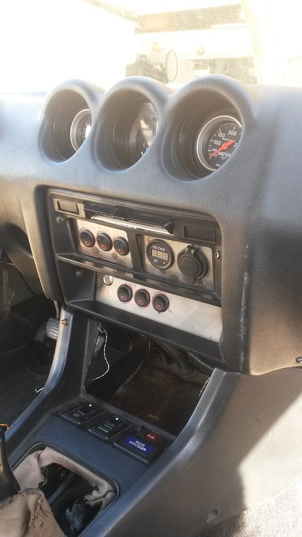

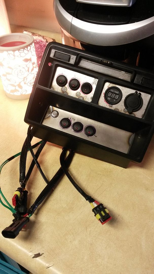

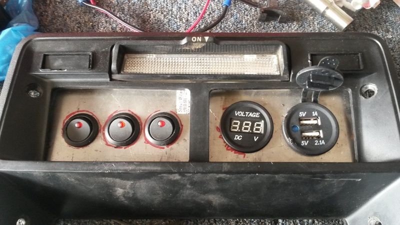

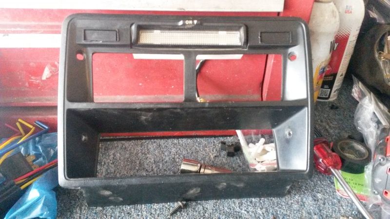

Drift Boss Posted January 1, 2016 Author Share Posted January 1, 2016 Pan on covering the panel with black fabric. Not sure what kind yet. Quote Link to comment Share on other sites More sharing options...
Drift Boss Posted January 1, 2016 Author Share Posted January 1, 2016 Also plan on keeping the map light dully functional. =) Quote Link to comment Share on other sites More sharing options...

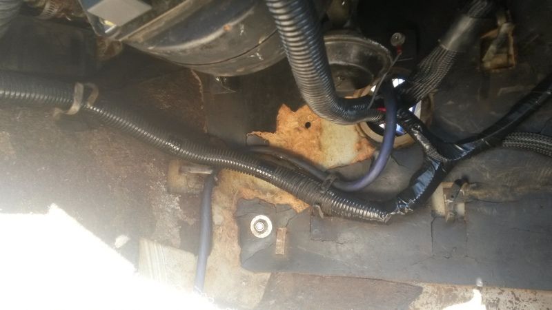

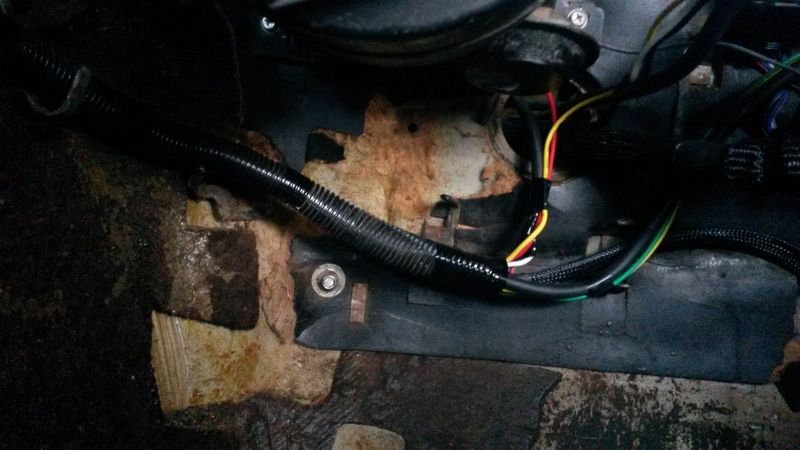

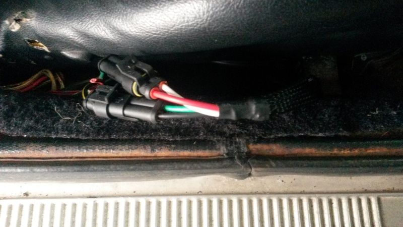

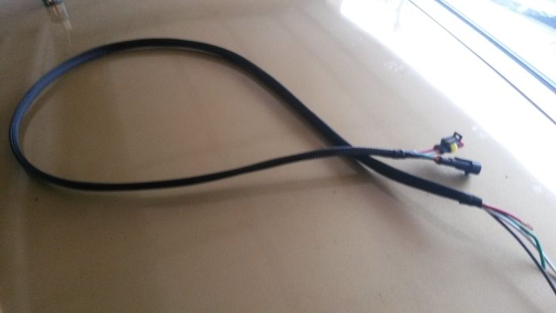

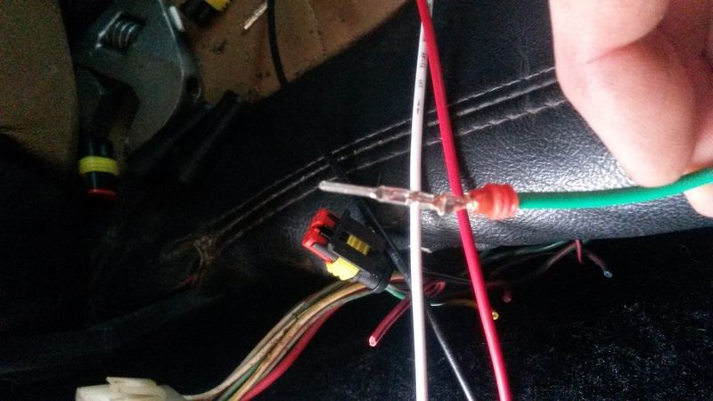

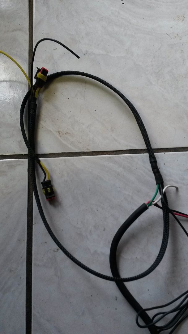

Drift Boss Posted January 9, 2016 Author Share Posted January 9, 2016 New rear tail light plugs/new loom/new wire. New headlight harness =) All new materials, no old stuff. Took about 4 days of solid work(only have about 3 hours a day) I was getting tired of doing the loom and these pins... . . Quote Link to comment Share on other sites More sharing options...

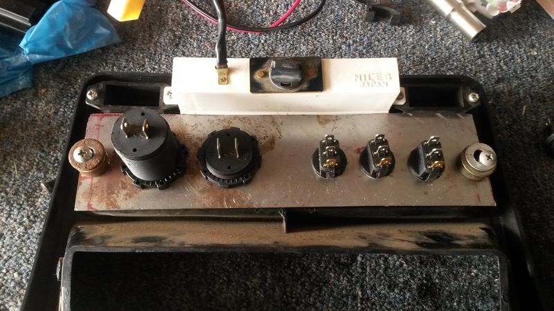

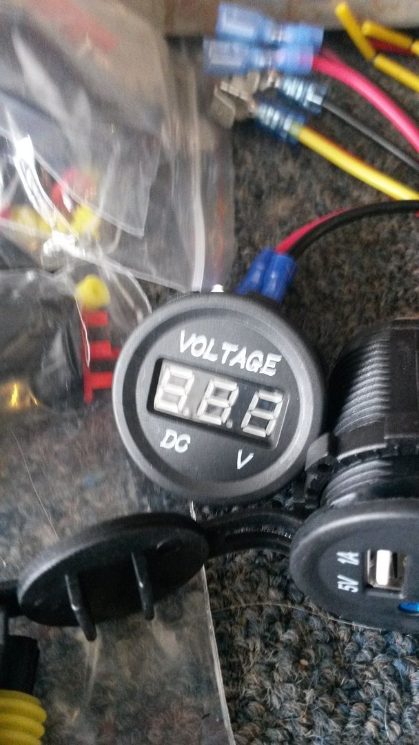

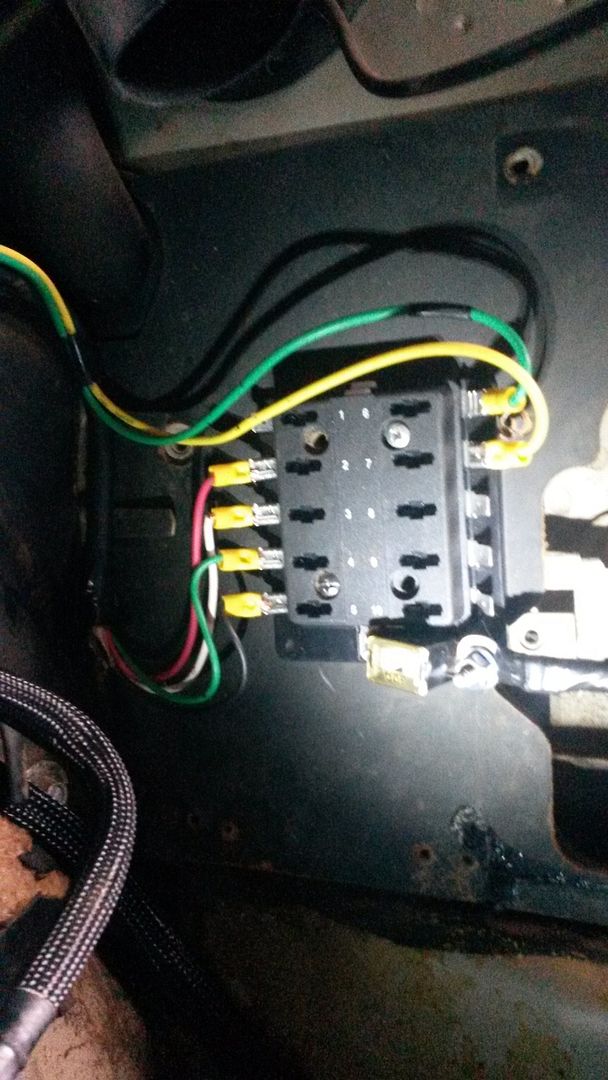

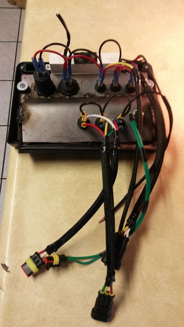

Drift Boss Posted January 9, 2016 Author Share Posted January 9, 2016 Here is the fuse box I am using. . Quote Link to comment Share on other sites More sharing options...
Drift Boss Posted January 9, 2016 Author Share Posted January 9, 2016 Believe it or not everything works now! I will take pictures later. Now I have another fellow s30 buddy in Oklahoma that want me to make him a harness! Arg! Lol Quote Link to comment Share on other sites More sharing options...

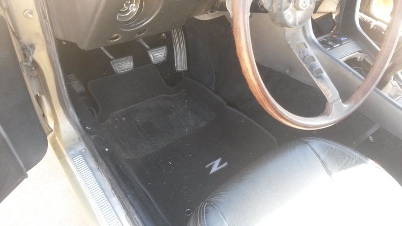

Drift Boss Posted January 19, 2016 Author Share Posted January 19, 2016 Welded up my own downpipe to 2.5in pipe all the way back. Man, I love the sound. It sounds mostly stock. =) I will make a video. As of right now, my alternator went out. After tons of run around research on the web...I decided to ignore it all and did my own research. I found a Lexus sc300 alternator works! Has to be 92 to 94. The 92 to 94 have the ROUND plug the 1jzgte requires Quote Link to comment Share on other sites More sharing options...
Drift Boss Posted January 19, 2016 Author Share Posted January 19, 2016 Also put in 370z floor mates and oem 240z steering wheel =) Quote Link to comment Share on other sites More sharing options...

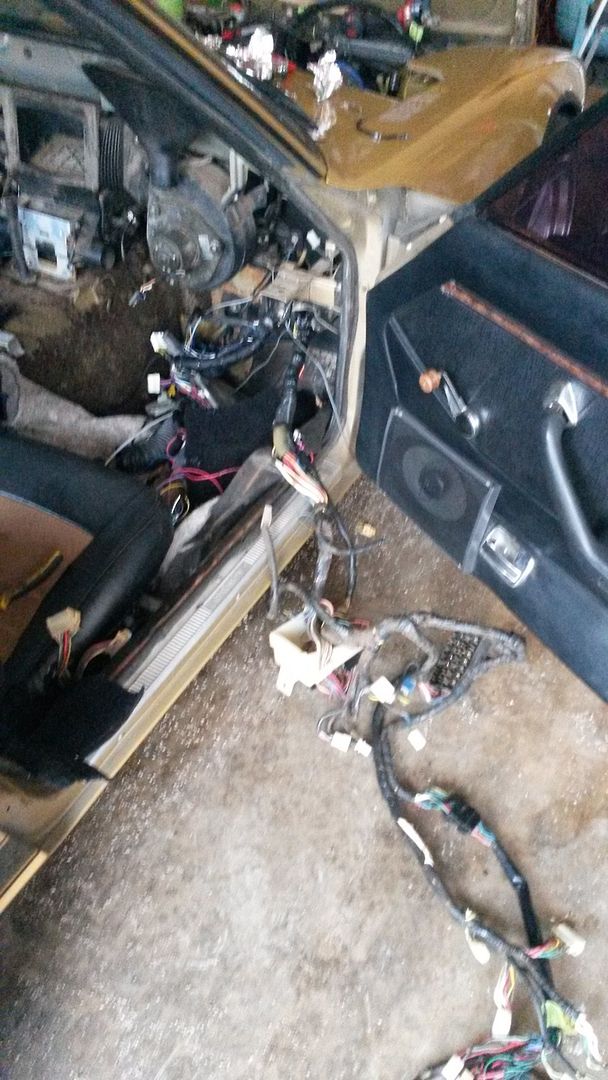

Drift Boss Posted January 29, 2016 Author Share Posted January 29, 2016 Quote Link to comment Share on other sites More sharing options...
Drift Boss Posted January 29, 2016 Author Share Posted January 29, 2016 Here is my new chassis harness 370z floor mates Quote Link to comment Share on other sites More sharing options...

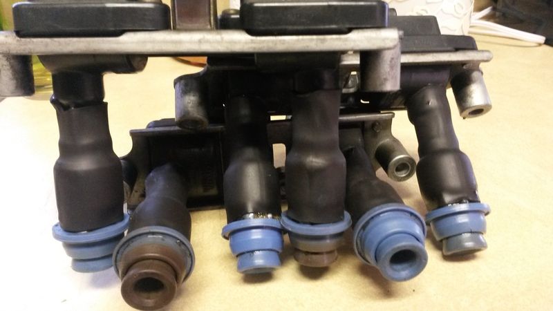

Drift Boss Posted February 1, 2016 Author Share Posted February 1, 2016 Had cracked coil packs, with misfire under load. I put heat shrink and new plugs in it, seems to doing great now. Quote Link to comment Share on other sites More sharing options...
