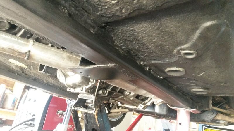

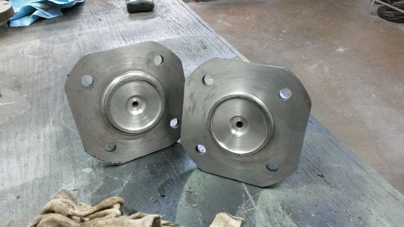

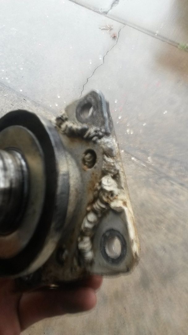

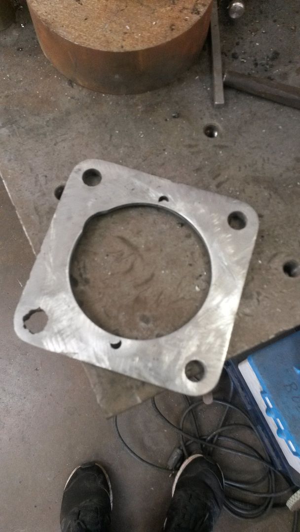

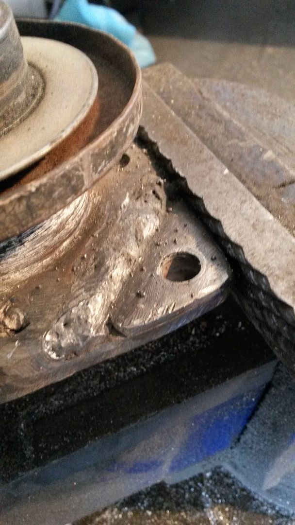

Drift Boss Posted February 24, 2016 Author Share Posted February 24, 2016 Not sure yet. It's just a little gas beater that gets me around town. I think me and a buddy are moving to Japan sometime this year. So I might be selling the s30 when I leave =/ or before I leave. Anyways, the previous owner installed Subaru axles, and made these fine gem adapter plates. Needless to say, I am grinding them down now and really welding them...I am not welder, but I can weld better then this garbage. Sorry I think my camera couldn't focus, to much shitty weld might have broke it. =) Quote Link to comment Share on other sites More sharing options...
Drift Boss Posted February 24, 2016 Author Share Posted February 24, 2016 Quote Link to comment Share on other sites More sharing options...

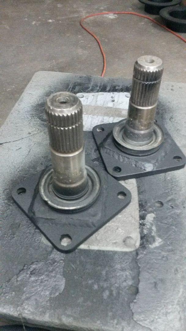

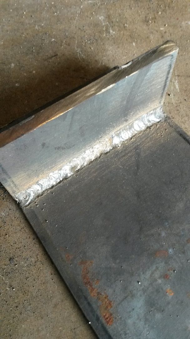

Drift Boss Posted February 24, 2016 Author Share Posted February 24, 2016 Better. Not saying it's a good weld, much better is all. Quote Link to comment Share on other sites More sharing options...

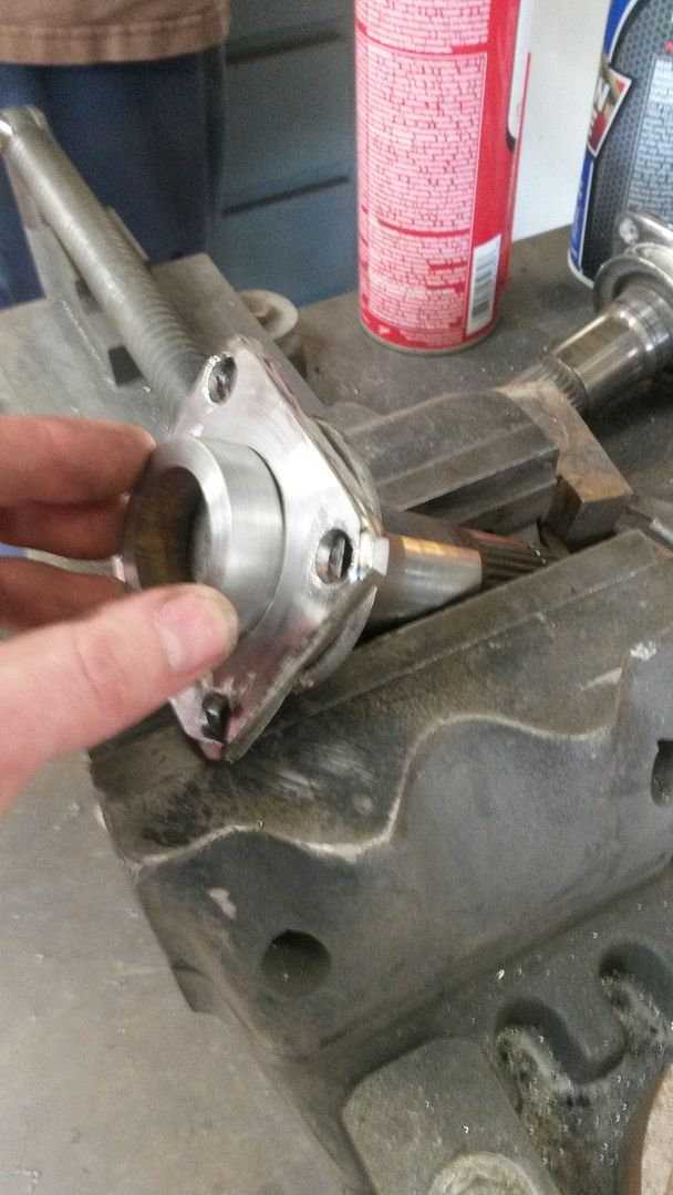

Drift Boss Posted February 24, 2016 Author Share Posted February 24, 2016 Oh, I am taking apart my sub axles. One has run out. Taking it to a very good lathe operator to true up the flange for me. (Bearings are fine, wheel wobbles, and has a vibration at 6th to 100mph) Quote Link to comment Share on other sites More sharing options...

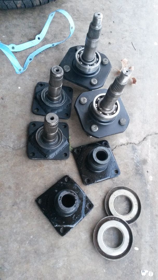

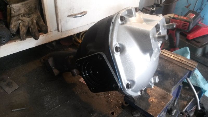

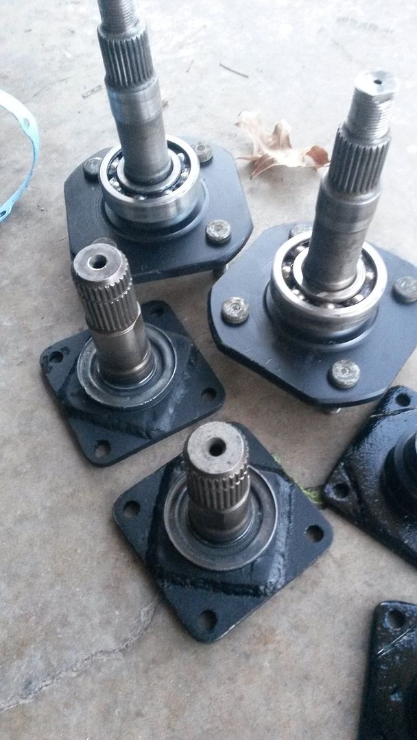

Drift Boss Posted March 2, 2016 Author Share Posted March 2, 2016 So...we really done everything. The last owner didn't true up anything. Just welded away, not knowing what is centered. He made a "jeg" to center off the oem circle off the hub, and flange. He straight up the flanges, and made them pretty. V Hit the old ones with a hammer, flange fell off... While I was waiting for him, I made a gasket and cleaned the rust off the r200 diff. Subaxles welded up. Whole "kit" I am not sure what the axles are to. I need to find out. Quote Link to comment Share on other sites More sharing options...

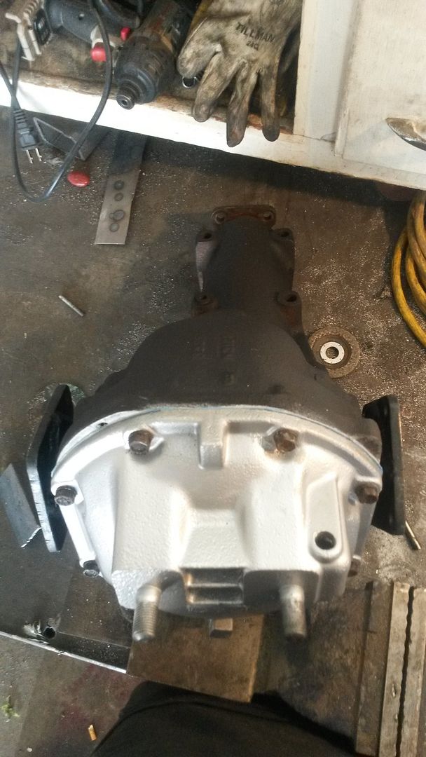

Drift Boss Posted March 2, 2016 Author Share Posted March 2, 2016 Quote Link to comment Share on other sites More sharing options...
Drift Boss Posted March 2, 2016 Author Share Posted March 2, 2016 Next is welding up the rear diff fir hood rat shit. I been looking for a locker for a 29spline r200...can't seem to find one. I see the jeeps dana35 look similar to our diffs spider gears. They do sell lockers for a jeep Dana 35 29spline...might make a trip to pull a part... Quote Link to comment Share on other sites More sharing options...

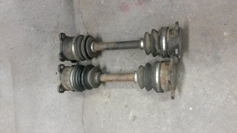

Drift Boss Posted March 10, 2016 Author Share Posted March 10, 2016 As you can see, I need 1 new axle...but I am not sure what the axles are to? Quote Link to comment Share on other sites More sharing options...

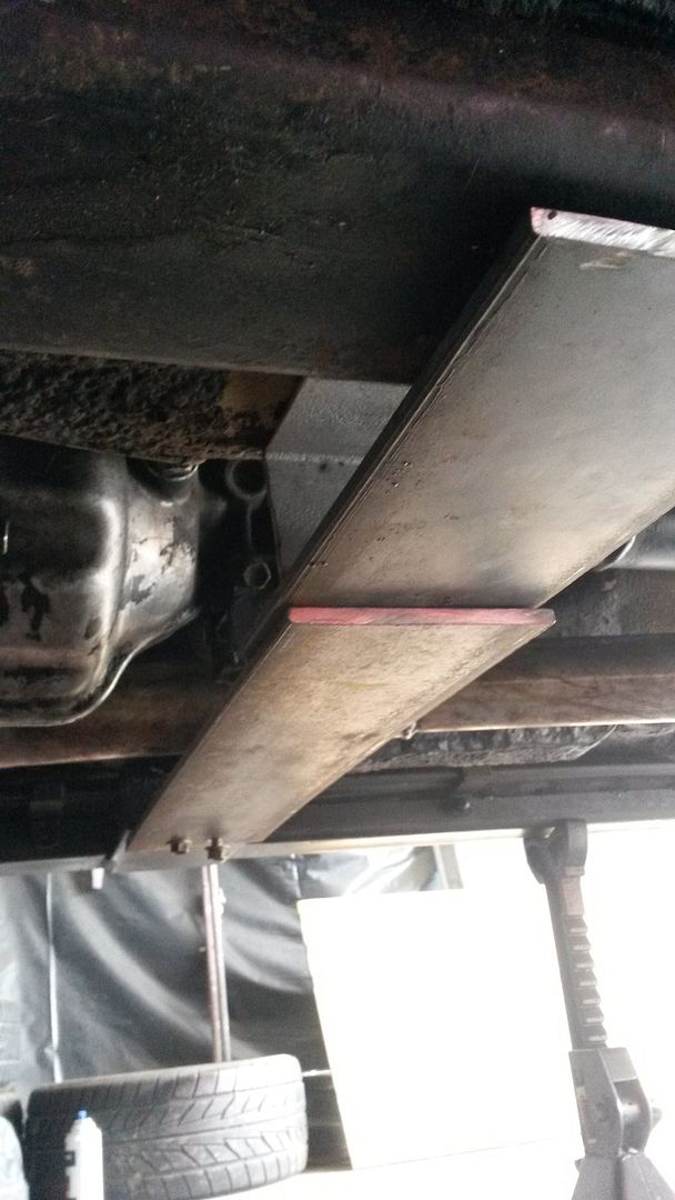

Drift Boss Posted March 20, 2016 Author Share Posted March 20, 2016 I wanted to remake my Trans mount cause my first one wasn't perfect. Had done flat steel laying around. Flare all things! Oh I made it to a drift event. Unfortunately it sucks at sliding(not a drift car) Quote Link to comment Share on other sites More sharing options...
