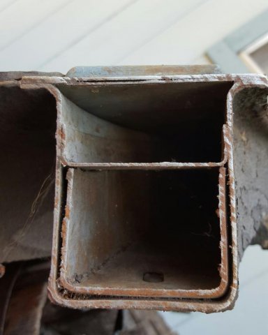

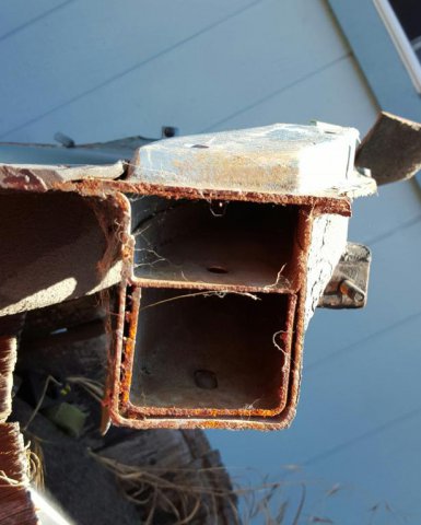

88dangerdan Posted July 15, 2015 Share Posted July 15, 2015 This should help Unless you plan on welding in a flat plate, I wouldn't. Quote Link to comment Share on other sites More sharing options...
johnc Posted July 16, 2015 Share Posted July 16, 2015 Those structures were added to meet DOT crash regulations starting in the 1977 model year. They are a safety item. Your call on whether you want them in the car or not. Quote Link to comment Share on other sites More sharing options...
ferrariowner123 Posted July 16, 2015 Author Share Posted July 16, 2015 (edited) Whoa, awesome picture and info, sounds like I'm gonna put a piece in place of it then. Since 1/4 inch is as high as my Welder were go, I'm think that should work. Since it's spot welded it, I don't see any issues with plug welding the new bar in place, does that sound reasonable to everyone? Thanks again for the awesome info. -Kyle Edited July 16, 2015 by ferrariowner123 Quote Link to comment Share on other sites More sharing options...
rturbo 930 Posted July 16, 2015 Share Posted July 16, 2015 (edited) Measure the thickness of whatever came out, and use that. 1/4" thick is waaay overkill. BTW, in the pic that Dan posted, it's not easy to see, but it looks like the floor goes across the top, so if you take that piece out, there won't be an opening into the rest of the subframe. No need to add anything back in. Edited July 16, 2015 by rturbo 930 Quote Link to comment Share on other sites More sharing options...
88dangerdan Posted July 16, 2015 Share Posted July 16, 2015 Cleaned it up a little Quote Link to comment Share on other sites More sharing options...
ferrariowner123 Posted July 16, 2015 Author Share Posted July 16, 2015 (edited) Rturbo 930- Wouldn't the box shape provide additional stiffness or rigidity? So If I'm going to take that piece out and replace it with a flat piece of steel,(per the recommendation of those here) putting that thin 18 gauge (or whatever thickness it is) in place would make it less stiff than when it started. So to make up for the strength but using less space, it would have to be a thicker steel? Right? While I will concede 1/4 might be a bit much, going to that thin OE thickness sheet metal seems like a waste of time. I'm thinking 3/8th's might be a winner here. Would everyone say that would be a safe choice? Thanks again for the pictures Dan. Gotta ask, did you just have that cut away lying around or did you do that for little Ole me? Lol Thanks again for all the input guys, really appreciated. -Kyle Edited July 16, 2015 by ferrariowner123 Quote Link to comment Share on other sites More sharing options...
88dangerdan Posted July 16, 2015 Share Posted July 16, 2015 I actually have the complete spare tire well cut out of a 77 280z in the shed. Quote Link to comment Share on other sites More sharing options...
