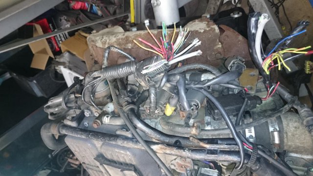

Stano71 Posted October 28, 2016 Share Posted October 28, 2016 (edited) The chopped harness is the biggest hassle, dropping this one in my z31 at the moment nearly there just need to sort wiring. using a z32tt auto harness and ecu and airflow, z32 na flywheel to fit 71c gearbox(bellhousing) and 4.11 diff .it is impossible to find a wiring diagram but I have almost completed tracing all the wires out. Will share MY wiring config/ diagram when engine is running correctly as it seems like nobody else has documented it . maybe others who did this swap had a good harness to start with? anybody got more info they would like to share? Wiring diagram would be great Edited October 28, 2016 by Stano71 Quote Link to comment Share on other sites More sharing options...

Stano71 Posted October 30, 2016 Share Posted October 30, 2016 (edited) I found some good info at this Japanese(translated link) site for the CIMA which had VG30det .Has info for Early and Late models, series 1(red covers), mine is series 2(silver covers) . ECU PINOUTS for ecu with 4 separate plugs(early) AND ecu pinout for ecu with one large Blue plug(late) same as z32 etc plus info on other sensors etc .well worth a look for VG30DET info https://translate.google.com/translate?depth=1&hl=en&prev=search&rurl=translate.google.com.au&sl=ja&u=http://www.geocities.jp/blue31cima/index.htm Edited October 30, 2016 by Stano71 Quote Link to comment Share on other sites More sharing options...
