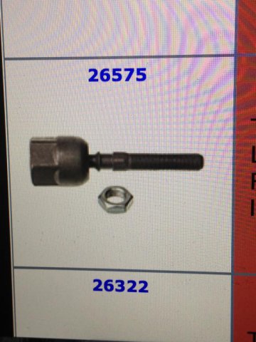

RebekahsZ Posted August 7, 2015 Share Posted August 7, 2015 (edited) Does anyone have any experience with the I inner tie rods from Rare Parts?? The first photo is my current tie rods. The second is the picture the inner tie rod style shown on the Rare Parts on-line catalog. Hoping for some input before I plunk down $200 for a pair. Edited August 7, 2015 by RebekahsZ Quote Link to comment Share on other sites More sharing options...
socorob Posted August 7, 2015 Share Posted August 7, 2015 Ask Gabe from TTT. I found that place mentioned in his ad for his outer tie rod ends. Quote Link to comment Share on other sites More sharing options...
takayuki Posted August 7, 2015 Share Posted August 7, 2015 I have them in my 260z. They looked different from the oem ones but the length and fitment is good. Quote Link to comment Share on other sites More sharing options...
RebekahsZ Posted August 7, 2015 Author Share Posted August 7, 2015 (edited) I think I love you (both). I'm ordering two pair tonight. Edited August 7, 2015 by RebekahsZ Quote Link to comment Share on other sites More sharing options...

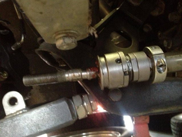

RebekahsZ Posted October 11, 2015 Author Share Posted October 11, 2015 (edited) Dexter and I got just a little time in on the Z yesterday and we managed to get the old inner tie rods off (definitely a 2-man job). At the factory they must use a spanner wrench of some kind a (and a lotta torque) to install the inner tie rod ends. There is a lock nut that has a large hex profile that I was able to buy an open end wrench to fit. But we had to use a monkey wrench (pipe wrench?) to bite into the tie rod end to break the torque. I would not try to do this without having some way to avoid twisting the rack itself as you struggle to break that tie rod loose. After getting the luck nut broken free, the tie rod was still affixed to the rack with red lock tite. Fortunately, I had installed travel limiting collar clamps onto the rack itself and I was able to put a second monkey wrench on that to restrain twist of the rack adequately to get the inner tie rod end off. The other side was just a repeat. Both sides of the rack use standard, right-handed threads, so both sides come off counter clockwise. A quick test fit of the Rare Parts tie rod ends confirms that they fit. Pictures and more good things to like about the Rare Parts inner tie rods after church. Edited October 11, 2015 by RebekahsZ Quote Link to comment Share on other sites More sharing options...
