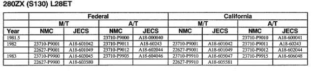

Here are a couple of sources.  But if you're running the 1978 NA ECU, you must be running an NA distributor also, not the CAS that the ECU needs.  The 1978 ECU doesn't do ignition control.  You need the whole ECCS (S for System), or aftermarket engine management like Megasquirt.
http://jimwolftechnology.com/wolfpdf/ecu-id.pdf
http://www.jatan.net/tsbs/040359.pdf

Those links are very helpful thanks! but once again it conflicts with everything I have found so far... according to that the proper ECU # is: A18-604 046... I think you're right, I may just go completely aftermarket since I'll most likely have to replace everything anyways :(

I don't see 604 046 anywhere on the official Nissan factory Technical Service Bulletin.  That's the one I'd use.  The jimwolf page might be misleading.
Edit - actually I did find it. The other ones might work too though.  Are you running an automatic?

It's extremely easy to tell if you have an ECCS ECU (Turbo) or an EFI ECU (N/A).  Just look at the ECU connector.  The L28ET ECCS ECU has three black plugs that the harness connects to.  The L28E EFI ECU has ONE long plug.
You can use any '82 or '83 ECCS ECU with that engine ("automatic" or "manual" doesn't really matter).  BUT, if you're using the stock ECU, you'll need a stock ECCS harness.  SO...  If you need both an ECU and a harness, you can use any ECCS harness and it's matching ECU.  What I mean by that: You can use an '81 ECCS ECU and harness (the harness will have (and need) dropping resistors) on any L28ET.  You can also use an '82 or '83 ECCS harness and ECU (no dropping resistors on the harness).  The '82 and '83 are interchangeable.
The only other early ECU that uses 3 black plugs is a Z31 ECU (early 300ZX).  A few folks use a Z31 ECU to run their L28ET's BUT it needs to be rewired slightly to make it work properly.  Well documented in archival threads.  Would have been helpful if you'd posted pictures of what you have...
