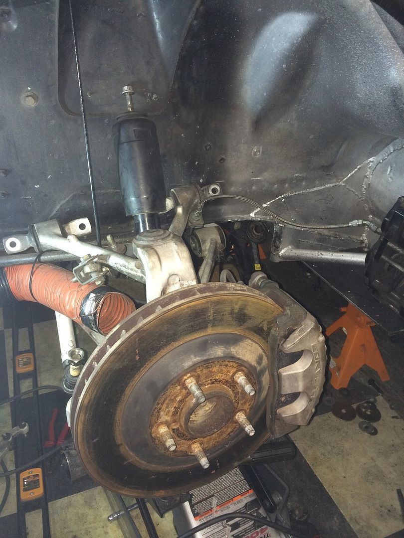

Not sure I have it in me to go through the effort but other than the upper coilover mount doesnt look too hard. FYI Z front suspension is 46 lb (big brakes) and the C5 is 52 lb with a shock but without a coilover. Think the strut is a limiting performance factor - lap times - and I need to replace (again ... worn out two sets now) Konis and other maintenance so it's tempting. So would it be worth it over a well set-up Z strut? It wouldnt be cheap but biggest fear is new learning curve setting it up.

I have seriously been considering some sort of SLA front suspension.  The C6 is a logical choice for a donor.  One of the things that concerns me about the C6 set-up will be the necessity of using 18 inch wheels.
I would love to be able to use 15 or 16 inch wheels with whatever SLA set-up that I go with.
Already use 25" tires so that's not and issue for me. Yes lots of tire options in 18". However, more I look at it and to do it most efficiently one would want to cut out most of fhe front end. Moving the load path from the strut tower down lower to basically part way up the side of thd strut tower would need a lot of reinforcement. Not sure Im ready yet to lop off the front end and completely rebuild it.

Around 10 years ago, there was a fellow in the Northern Virginia area - a law-student at the time - who was grafting a C5 front-end onto his S30.  I believe that welded together an entire tubular front clip, accommodating the C5 steering rack, K-member and front suspension.  For the rear, he was using a C4 suspension and another custom tubular assembly.  For the middle there were evidently some Datsun parts.  I'm not aware of the disposition of this project, as he's been absent from this Forum for years.
There is indeed an incisive philosophical point about a level of modification at which point one might as well start afresh with a brand new car.  This is more about cost/effort than about "purism".  Still, the enduring appeal of the S30 Datsun is the light weight, compact size and shortcuts in registering such an old car.  A 500+ lb weight advantage over the C5 or C6 is not nugatory.
