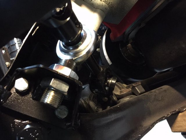

I relocated the steering shaft to make room for long tube 1 3/4" primary tube headers and wanted to share the results through a few pictures.
3/4" shaft support bearing, 3/4" shaft, 3/4" smooth wall u-joint, and a 19/32 drill bit were all that was needed.
I should have ample clearance for any header on this side of the car. The passenger side is now the only concern.
