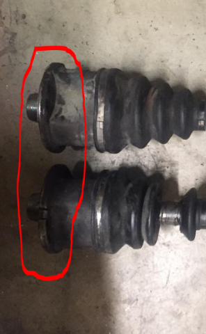

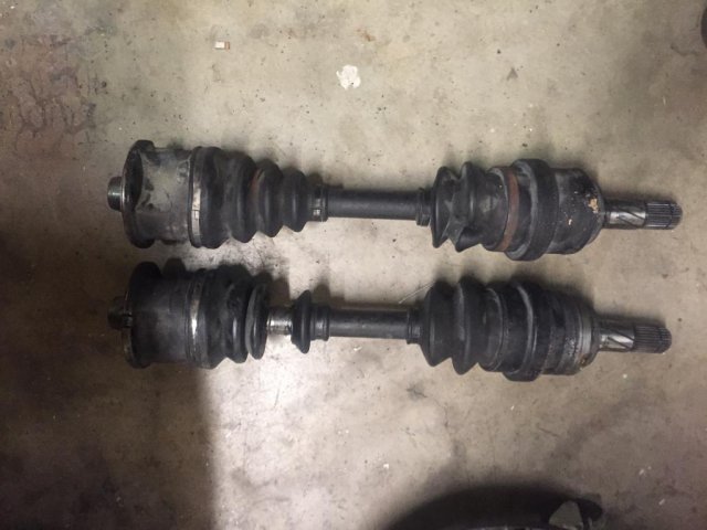

fyanrudger Posted January 14, 2016 Share Posted January 14, 2016 Sometimes I feel smart, other times I read up on stuff and just feel my eyes roll back into my head. In this case, I did not do the R200 conversion on the car and need to replace a axle...so I'm confused as to what's on the car. I believe they're 280zx axles, but the specifics (year, turbo, non-turbo) and weather or not these are some converted, companion flange units is lost on me. Here's a photo. Where can I buy a replacement. Thanks! Quote Link to comment Share on other sites More sharing options...
malibud Posted January 14, 2016 Share Posted January 14, 2016 Those look like zx turbo CV axels ... N/A item as far as I know you will have to find usd or rebuild. I think they are different length as well Quote Link to comment Share on other sites More sharing options...
NewZed Posted January 14, 2016 Share Posted January 14, 2016 (edited) What kind of car? How many holes? Edited January 14, 2016 by NewZed Quote Link to comment Share on other sites More sharing options...
fyanrudger Posted January 14, 2016 Author Share Posted January 14, 2016 (edited) This is on a 72 240. Six holes. Driver side axle is shorter. Edited January 14, 2016 by fyanrudger Quote Link to comment Share on other sites More sharing options...
NewZed Posted January 14, 2016 Share Posted January 14, 2016 Those are 280ZX Turbo axles. Also used on the 2+2, I think. Put an ad in Parts Wanted for six hole 280ZXT CV axles. and you might find some used ones. Some parts stores might have them also but apparently the remans get their lengths all mixed up and people end up with axles that are two long. Be careful. Or there's the internet. Quote Link to comment Share on other sites More sharing options...
