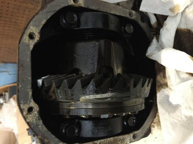

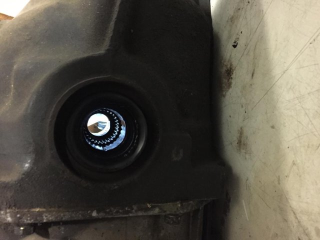

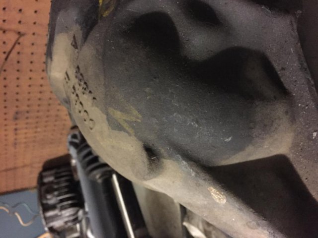

kevinz Posted January 25, 2016 Author Share Posted January 25, 2016 It's a clutch. I was looking for differences without opening up the cover. I noticed that when you take out the shafts that there is nothing obstructing the view on an lsd and there is on an open diff. I don't know if it's that way on all of them or not. Also noticed on the top of lsd that there is a small raised area about 1"X1" that is not on my open diff. Has anyone noticed this before. I can't figure out how the heck to post a pic or I would. Quote Link to comment Share on other sites More sharing options...

kevinz Posted January 25, 2016 Author Share Posted January 25, 2016 This is the hump that's on the lad case Quote Link to comment Share on other sites More sharing options...
kevinz Posted January 25, 2016 Author Share Posted January 25, 2016 Quote Link to comment Share on other sites More sharing options...
kevinz Posted January 25, 2016 Author Share Posted January 25, 2016 And it's clear all the way through Quote Link to comment Share on other sites More sharing options...
kevinz Posted January 25, 2016 Author Share Posted January 25, 2016 On 1/25/2016 at 1:59 AM, kevinz said: And it's clear all the way through Quote Link to comment Share on other sites More sharing options...
