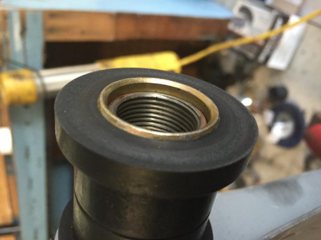

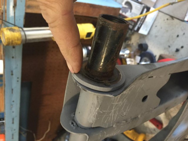

kevinz Posted January 30, 2016 Share Posted January 30, 2016 Do these have to come off for the urethane bushings. It's been so long I don't remember. Quote Link to comment Share on other sites More sharing options...
kevinz Posted January 30, 2016 Author Share Posted January 30, 2016 With them in place the bushings stick out a little. Quote Link to comment Share on other sites More sharing options...
z240 Posted January 30, 2016 Share Posted January 30, 2016 All is good as is. Nothing to remove from the control arm. Quote Link to comment Share on other sites More sharing options...
kevinz Posted January 30, 2016 Author Share Posted January 30, 2016 Thanks. Quote Link to comment Share on other sites More sharing options...

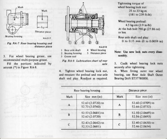

z240 Posted January 30, 2016 Share Posted January 30, 2016 There is torque spec to check that rotation tightness. It's not very tight, you can turn it easily by hand, but it feels nice and stiff and smooth. You cannot make it spin free with a flick of your wrist for example. I think of it as the feel of a really old high end stereo volume knob. It feels like the knob weights about 10 lbs. Does the rotation have tight and loose spots? Shouldn't. First obvious question is did you remember to put the distance piece (that spacer pipe) in between the two bearings? Were the bearing seats perfectly clean so the bearing seat dead square? What torque did you tighten the big nut to? Quote Link to comment Share on other sites More sharing options...
johnc Posted January 30, 2016 Share Posted January 30, 2016 There is a spec in the FSM for the rotating torque and end play. That's when there is a torque range for the nut. You torque to the lowest number on the torque spec and then measure me pnay and rotation torque. Quote Link to comment Share on other sites More sharing options...

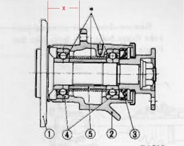

Miles Posted January 31, 2016 Share Posted January 31, 2016 (edited) You may need to disassemble the stub axle and make sure the bearings are seated or that you didn't leave out the spacer. Note that the spacers are matched to the hub. See attached pictures from the FSM. Edited January 31, 2016 by Miles Quote Link to comment Share on other sites More sharing options...

johnc Posted February 1, 2016 Share Posted February 1, 2016 Sometime the inside hub seal is not seated completely and that causes additional drag. Its supposed to be recessed into the hub. Some folks install it flush with the inside hub face and that causes a lot of drag. The seal will fail very quickly in use if not seated properly. Quote Link to comment Share on other sites More sharing options...
