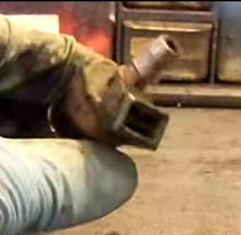

annoyingorange Posted April 30, 2016 Share Posted April 30, 2016 What do I have to cut, file or shave out of the injector to fit in barbed style fuel rail?? I could not find anything. Thanks Quote Link to comment Share on other sites More sharing options...

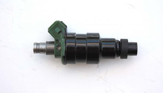

NewZed Posted April 30, 2016 Share Posted April 30, 2016 It's not normally done. There's only a tiny stub at the top of modern injectors after you cut the plastic away. Not much to fit a hose and hose clamp on to. And it's not a barb, it's just a round tube shape. Looks like these guys are doing that modification and selling them as replacements. But it's kind of a hack job. The injector companies put those barbs on there for good reason. With no flare and no barbs the hose could easily pop off. https://www.fiveomotorsport.com/fuel-injectors/nissan/280zx/ pallnet sells rails for the Z engines that will take o-ring injectors. http://forums.hybridz.org/topic/99098-pallnet-fuel-rails/page-15 Quote Link to comment Share on other sites More sharing options...
SleeperZ Posted January 31, 2018 Share Posted January 31, 2018 It is kind of a hack job. I did that mod on SVO injectors years ago, and it worked just fine. But now I am using the O-ring fuel rail. Quote Link to comment Share on other sites More sharing options...
