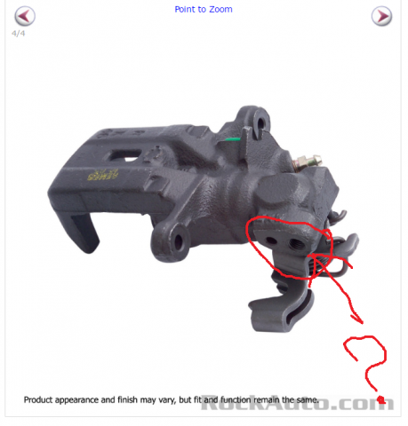

I am doing the S13rear caliper mod to my '78 S30. I have Raybestos rebuilt calipers, the modern motorsports brackets, the Z31 rotors, and some sweet sweet brakelines from Apex. But my concern is what is supposed to go here (see attached pic) I am thinking this might have something to do with the ebrake? Does anybody have some part numbers for the bracket and bolt that does here?
Attached pictures show the 240SX parking brake bracket. The hole where the 240Z  parking brake cable attaches to the 240SX bracket is too big so I modified the bracket by cutting off the end and welding on  the cable attachment part of a 240Z bracket.
cool. do you think the tack welds are strong enough to handle the force of the ebrake cable?
