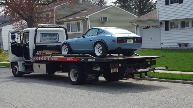

grillhands Posted September 16, 2016 Share Posted September 16, 2016 (edited) Just to put in perspective I cut the floors out of my 280z and replaced them with ZED Findings setup. I welded them in then had it towed to a shop to check my work and install new rails. They also repaired rust in my engine bay. That cost me 1700 in labor. The price for the floors and rails was close to 400. The time I put in myself was probably 30hrs. Rust is a mofo!!! Edited September 16, 2016 by grillhands Quote Link to comment Share on other sites More sharing options...
grillhands Posted September 16, 2016 Share Posted September 16, 2016 Here is my baby Quote Link to comment Share on other sites More sharing options...
