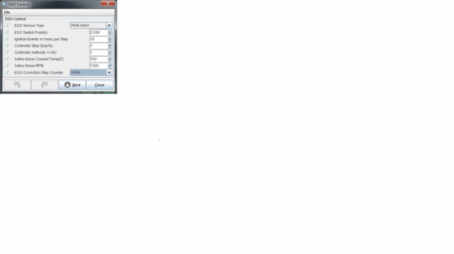

wigenOut-S30 Posted October 5, 2016 Author Share Posted October 5, 2016 Thanks for your response!.. I have tried tuning non open loop and open loop.. both do the same hunting for AFR.. I looked at EGO control and I do not see anything that refers to PID. here is a screen shot as to what I see for EGO. Quote Link to comment Share on other sites More sharing options...
jacky4566 Posted October 5, 2016 Share Posted October 5, 2016 Ah i didn't know you are using MS1. Do you have a thread on MSextra yet? Those guys are the real guru. Post your MSQ and i can probably help a bit more Quote Link to comment Share on other sites More sharing options...
