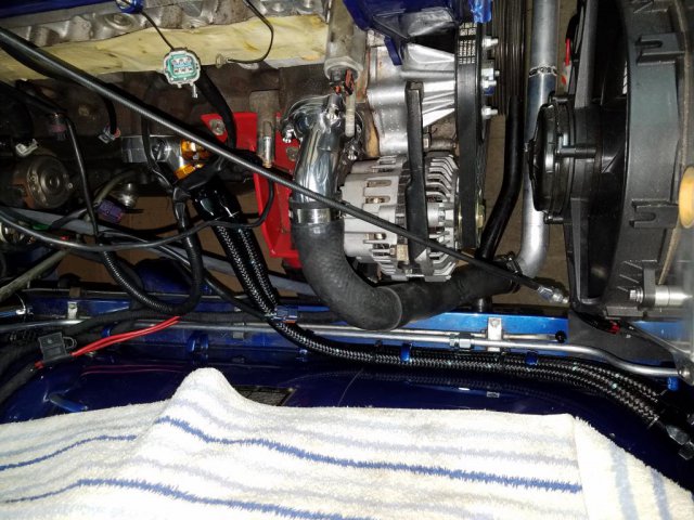

boosted300 Posted December 30, 2018 Share Posted December 30, 2018 Fellas I recently upgraded to a 180A LS1 alternator with the help of a kit from Raw Brokerage. It's a pretty sweet and easy solution to get an upgraded alternator I wrote it up in my build thread, page 8...hope it helps! Quote Link to comment Share on other sites More sharing options...
