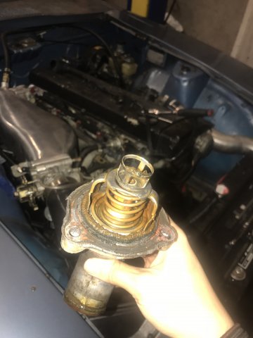

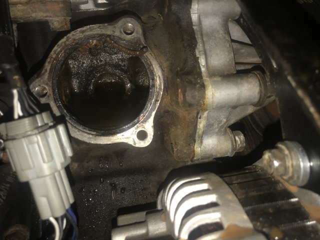

juliarosario Posted February 6, 2018 Author Share Posted February 6, 2018 Alright, so I was at the shop and I am itching to change the thermostat. I ended up buying a 300zx thermostat, reading on the forums that they were interchangeable for my RB. Let me start off by saying the bolts for the thermostat housing are in the MOST INCONVENIENT, ANNOYINGLY IRRITABLE SPOT. So. First, I got the car on the lift and drained the radiator fluid through the drain at the bottom. Let me just say that fluid was horrid. It smelled like nothing I have ever smelled before. It was this light brown liquid sparkled with flakes of rust and again, it smelled horrible. After it all had all drained out I put the bolt back in the radiator and lowered the car to the ground. Next, I disconnected the top radiator hose and the bottom hose. At one point some of the fluid left in the bottom hose leaked out onto my hand and I honest to god thought my skin might start crawling off. Anyways, with the hoses out of the way I only had to deal with the placement of the thermostat housing bolts. There were three of them. It took me about 20 minutes to get all three bolts off. There was a lot of swivel ratcheting going on, some difficult flashlight placement and so much excitement when the last bolt finally came off!! I nudged on the housing until it finally cracked off. More of that brown water leaked on my hand it was a nice time. Look at that!! So much rust and what a horrible rtb job. Kind of gross but also kind of cool to see that all this was in my engine and now has the opportunity to get cleaned out! And look at where the housing bolts up to, so gross right!? Quote Link to comment Share on other sites More sharing options...

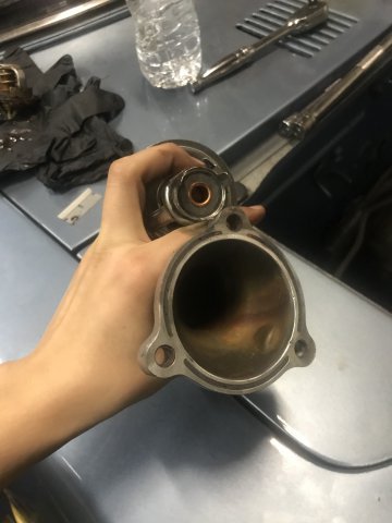

juliarosario Posted February 6, 2018 Author Share Posted February 6, 2018 So I scraped all that gross gunk off the engine and threw the old thermostat as far away from me as I could. I cleaned the housing itself and got it all ready to be bolted up again, when ready! Look how clean it I got it, pictured with the new thermostat! Quote Link to comment Share on other sites More sharing options...
juliarosario Posted February 6, 2018 Author Share Posted February 6, 2018 It was getting late and I realized I wanted to flush out my system so I waited until the next day to push my car outside and stick a hose in it! I put the house in the top of the engine where the upper radiator hose connects to and let the water run through the engine for about 45 minutes. I then put the hose where the bottom radiator hose connects to on the engine, turned up the water, and let it run through backwards for a while! After lunch I pushed the car back inside and decided it was time to piece everything back together. I made a gasket out of gasket paper matching up to my housing, fit the thermostat to the inside of the engine and got to work. It was kind of a hassle to keep the thermostat and the housing in just the right spot and then to get the bolts in just enough, only because the bolts were in such a tricky spot to get to! FINALLY, I get the housing fit on real nice, I cranked that beech on right. I jack the car up, only in the front, fill the radiator, start filling the block and SHIT, I'm seeing a leak. I'm so confused, I'm like damn is the gasket wrong, is something hanging out, do I really have to unscrew everything all over again?! The answer is yes to some of those questions. Turns out that when you "crank that beech" and over torque your bolts, your aluminum housing might crack! I cracked the housing right at one of the ears, not completely off but a nice thicCCCk crack. Just enough to have to unbolt everything, spill all the nice new radiator fluid on the ground, have a one or two casual mental breakdowns, weld the housing back to a normal state, bring the housing enough to let the bolts sit flush again, go back to the car, cut open ur hand maneuvering to get to these three bolts, praying to all the gods that the thermostat will line up with the gasket just right, and BAM, we are bolted up. SO, AGAIN, I start filling up the block with radiator fluid. Im waiting and waiting, knowing some fluid is gonna leak out this housing one way or another and... to my delightful surprise and long awaiting relief, NOTHING COMES OUT. I put back on the upper radiator hose, fill that as well and well, that killed a couple hours! But I was soooooo so happy to know the job was done! Quote Link to comment Share on other sites More sharing options...
