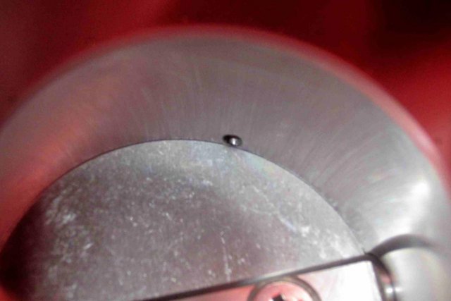

BJSZED Posted May 21, 2017 Share Posted May 21, 2017 Hi John, If it's not too much trouble, could you post a photo of the port vacuum hole in the throttle bore in relation to a closed throttle plate. I had a lot of trouble with that on my fitech and am curious if holley handled that better. I know on their carbs the position is perfect. Here is a photo of the stock fitect port vacuum hole with a closed throttle plate. Quote Link to comment Share on other sites More sharing options...
