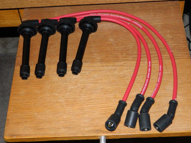

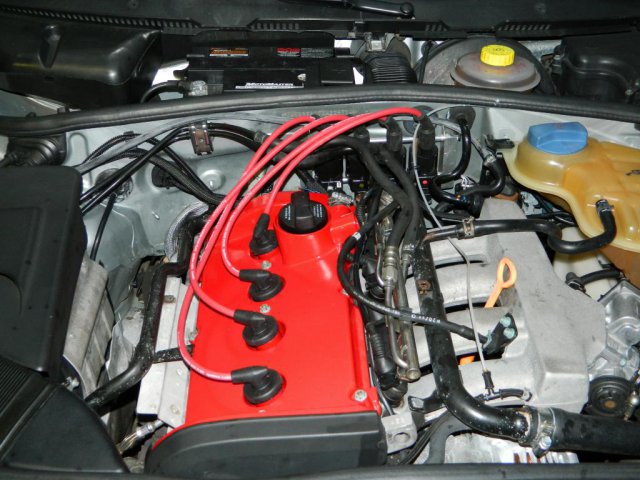

Chickenman Posted June 14, 2017 Share Posted June 14, 2017 (edited) Hanging the coils away from the engine is actually a good strategy. Wiyh any electronics device, the cooler thye run the better. Yes, thye probably will stand the heat located on the engine. But there is no doubt that thye will last longer running cooler. Aurora Electronics in Langley Canada make custom spiral core wires in any configuration you want . Any plug ends and any coil ends. Lifetime warranty as well. http://www.auroraelectronics.com/ I used Honda H series plug boots on my Audi 1.8T and they fit like a glove. This was when I was experimenting with an LS-2 CNP system. That didn't pan out due to ECU compatability issues with my AEB ECU ( long story, but dwell not easily changed on AEB ECU . Later models are dead simple to change Dwell ) ) but the setup worked very well. Lots of guys using LS2 coils ( D514 and D585 ) on Big Turbo Audi/VW 1.8T engines. Here's a picture of what my setup looked like during the test phase: Edited June 14, 2017 by Chickenman Quote Link to comment Share on other sites More sharing options...
