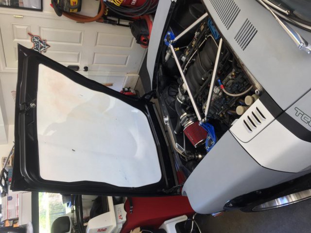

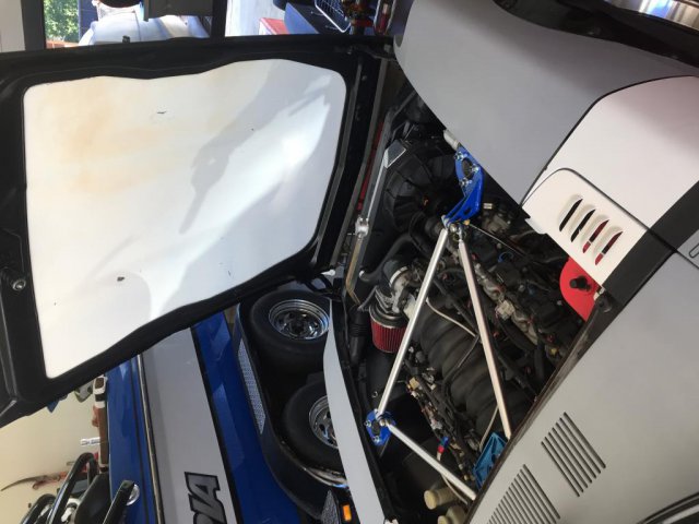

trackzpeed Posted May 28, 2017 Share Posted May 28, 2017 Top end told me there brace wouldn't work with my LS1 swap so I went with techno toy tuning. I don't have a picture on hand to post but there are some in my build log that may help you guesstimate what you need. Good luck. Jim Quote Link to comment Share on other sites More sharing options...

trackzpeed Posted May 29, 2017 Share Posted May 29, 2017 Keep in mind up running FI not a carb. I'd do some eyeball measurements before you order. Quote Link to comment Share on other sites More sharing options...
trackzpeed Posted May 29, 2017 Share Posted May 29, 2017 Quote Link to comment Share on other sites More sharing options...
