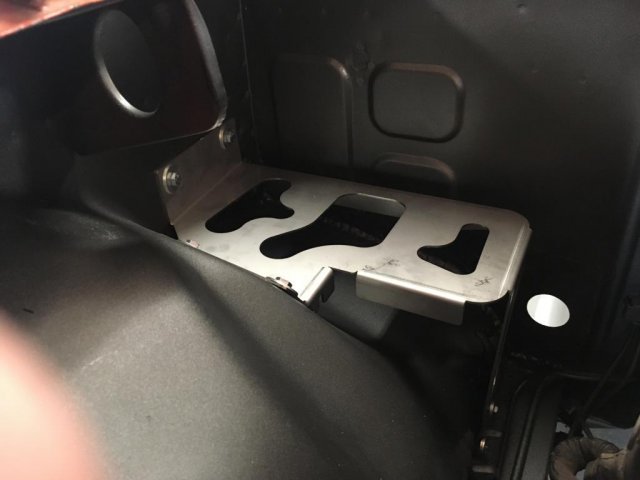

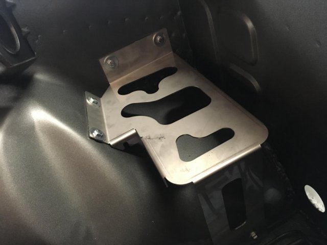

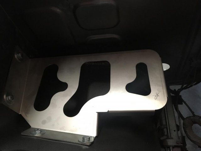

theczechone Posted July 21, 2017 Author Share Posted July 21, 2017 Just in case anyone has same questions as mine, I installed the battery tray this past weekend. The cheaper version tray feels very rigid and nicely made. The fit is quite good, better than i expected, didn't have to bend or adjust anything. Installation was as easy is setting it in place, drilling and deburring the holes. I used some black RTV on the bolts to prevent road grime to get into the engine bay. I used plastidip to coat the back side of the mating surfaces to create a "rubber layer" between the tray and the wheel well. This should also help with the galvanic corrosion issues mentioned in this thread. I also used large fender style washers to spread out the bolt loads. Here are some pictures. Quote Link to comment Share on other sites More sharing options...
