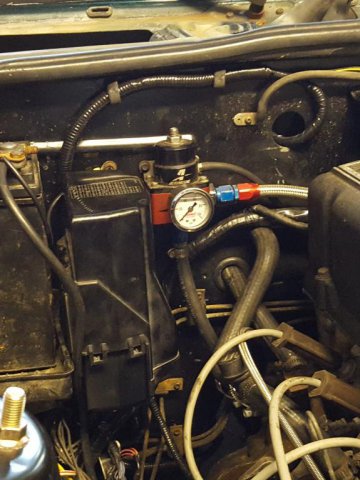

winstonusmc Posted August 19, 2017 Share Posted August 19, 2017 The vent line does go back behind the head and joins in with the rest of the fuel lines. I cut it off near where they all join up and connected it to a rubber hose. I installed the regulator directly above it in the firewall. Looked clean. The hard line joins in with a hose in the back that goes to the top of the vapor tank. If you don't rearrange it, it will still work. It will just sound like someone pissing in your gas tank. I put the return line in one of the vent lines in the top of the fuel tank right above the original lines. I then ran the line that came off that tank vent to the original return with some size reducing. Kinda switching the two hoses. Not really sure why your vacuum changes. Maybe when the fuel pressure equalizes, the engine runs the way it should, changing the idle load. Quote Link to comment Share on other sites More sharing options...
winstonusmc Posted August 19, 2017 Share Posted August 19, 2017 This shows where I put the FPR, directly above where I cut the vent line. Quote Link to comment Share on other sites More sharing options...
