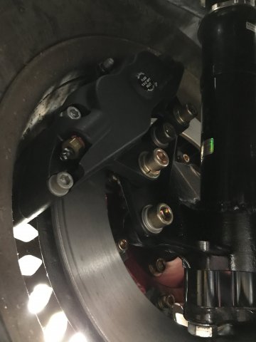

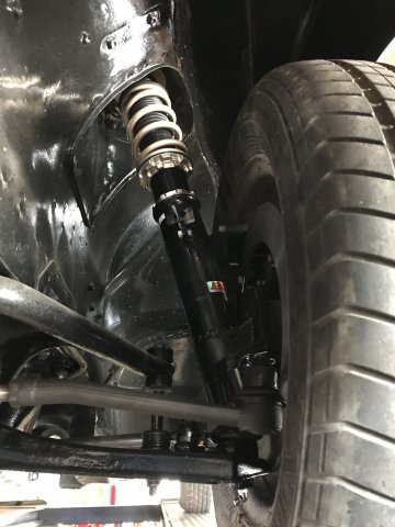

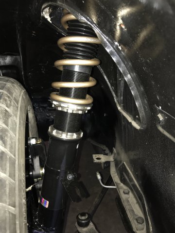

primaz Posted December 8, 2017 Share Posted December 8, 2017 we are about a month from completing the final assembly but here are some pics Quote Link to comment Share on other sites More sharing options...
