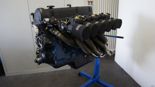

I'm new in this forum and hope to get some help regarding my Weber DCOE setting (Jet sizes, Tubes etc...).
I live in Germany and since four years I'm proud owner of a '74 Datsun 260z. I drove the car a few weekends and decided to restore and modify it a bit – which got even a bit more time after time.
One of the main modifications I’m doing is to swap the engine for a rebuilt L28.
This engine is soon ready for the engine dyno, but as I have no experience with the L6 I hope to get some help which carburetor jets (etc.) I should start with.
Actually the engine is at the dyno, so I can’t measure the DCOE parts that actually are installed - and I don’t get any details from Redline which carb-setup their kit has….
Here are some details about the engine I built:   (see added picture)
-          L28  F54 engine block with 89mm bore
-          L28 crankshaft weight-reduced, fine-balanced and temp-hardened
-          custom 89mm JE pistons
-          ARP H-shaft rods with L24-length
-          N42 head, ported, flow-optimized with 11.3:1 comp
-          44mm & 35mm valves
-          more aggr. camshaft
-          adjustable  pulley sprocket gear
-          Electromotive electr. Ignition
-          japanese stainless steel header and exhaust
-          Cannon manifold
-          3x Weber DCOE 45 (Redline Kit #K 659-45 4, Carb #19600.060)
-          open tubes / Ramair filters / K&N tube filters
There are a lot more details and modifications to it, but I hope these ones are the most necessary ones to know about.
Don’t hesitate to ask further – thanks in advance for you help!
Regards from Stuttgart,
Bastian

On ‎7‎/‎14‎/‎2018 at 7:37 AM, munters said:
I guess you will have a "hot" cam. I would start with w50 and vf tubes from keith frank at yahoo dcoe group. W50 is for avacuum below 19hg. Otherwise it would be a hypojet26 alsi from keith.
Im running his jets and they are incredible better then weber jets.
Grüsse aus der Schweiz
Nice! I've been eyeing those mods. Those are next...
