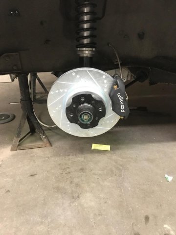

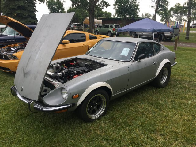

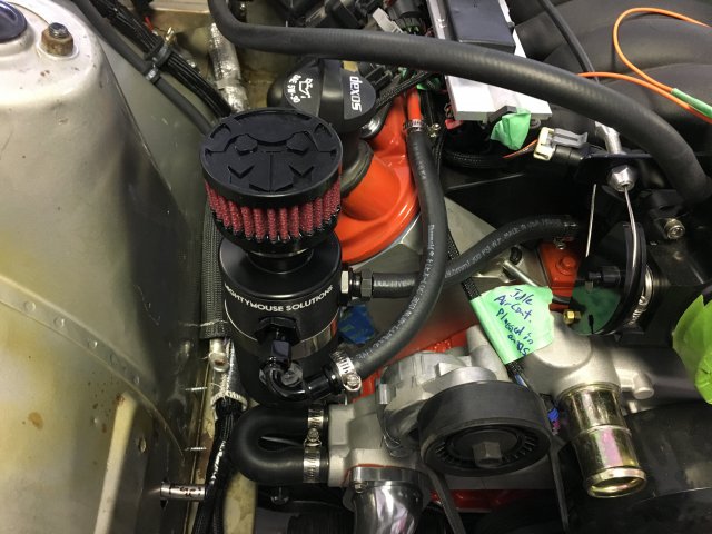

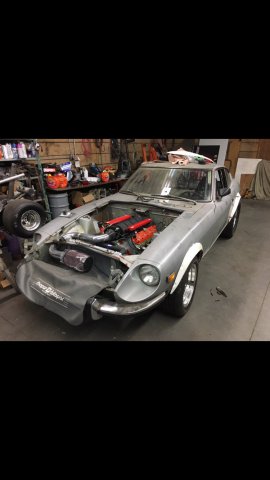

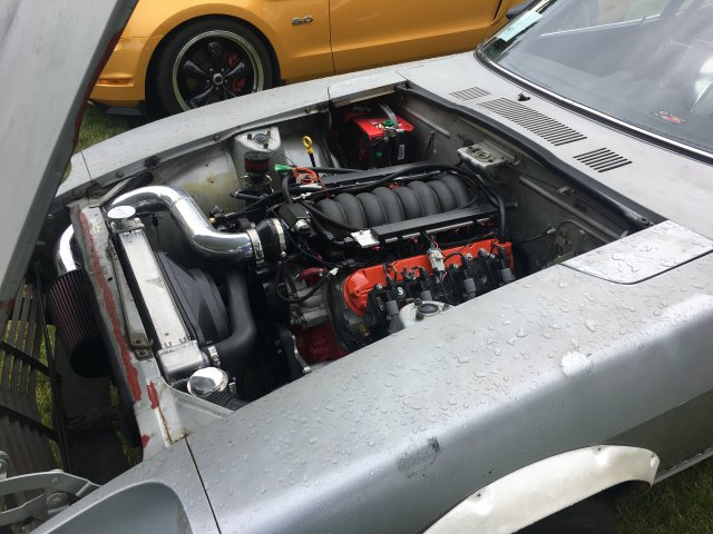

Hey Everyone, so I have been holding out a bit, I have posted on here a few times and have had awesome response so I wanted to finally post my build now that it runs and drives! Have just shy of 400 KM on it! Goal was a drag oriented street car! Fully street legal!
Build is a 1973 240z

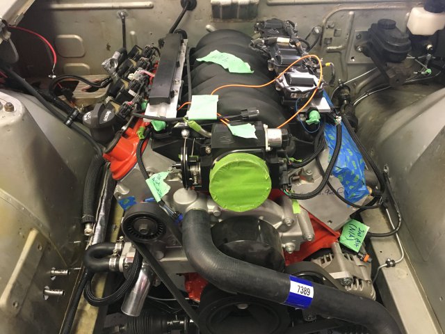

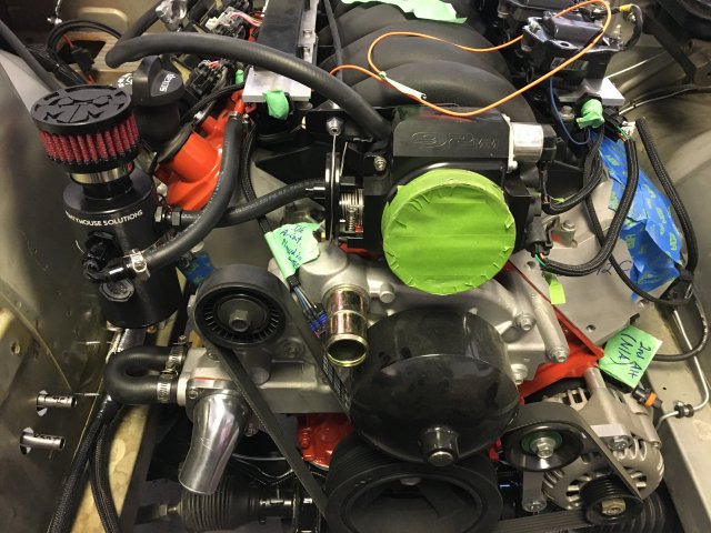

LQ4 stroker build, all forged SCAT internals, stroked to a 6.7L.
GMPP LS3 CNC heads with trunion upgrade and Bryan Tooley springs
Comp LSR Cam
LS3 intake
MSD Atomic EFI for LS

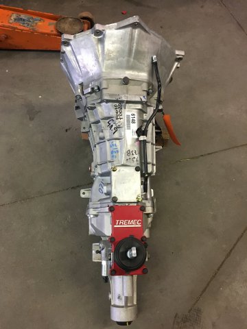

Tremec T56 Super Magnum

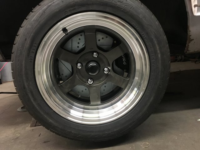

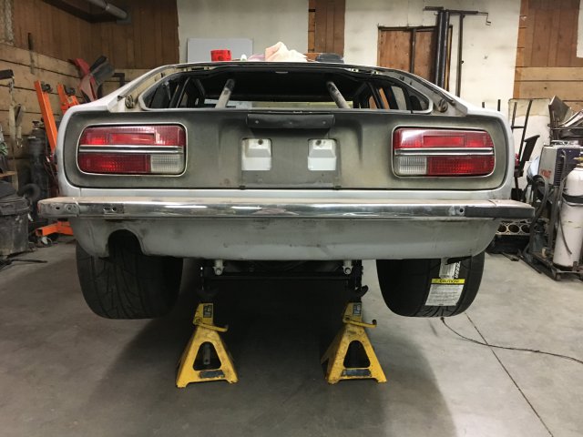

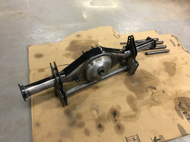

Ford 9”, all Strange Components, Spool Rear
Wilwood Brakes
Line Lock
Drag Radials

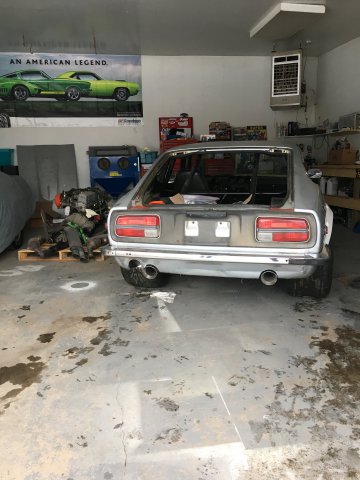

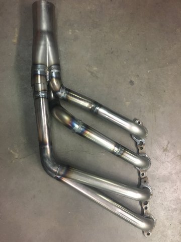

CustomLong Tubes, Flowmaster Exhaust
PW Radiator
No power anything lol.

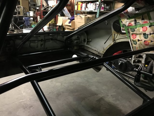

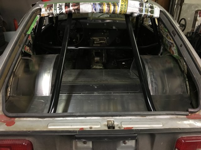

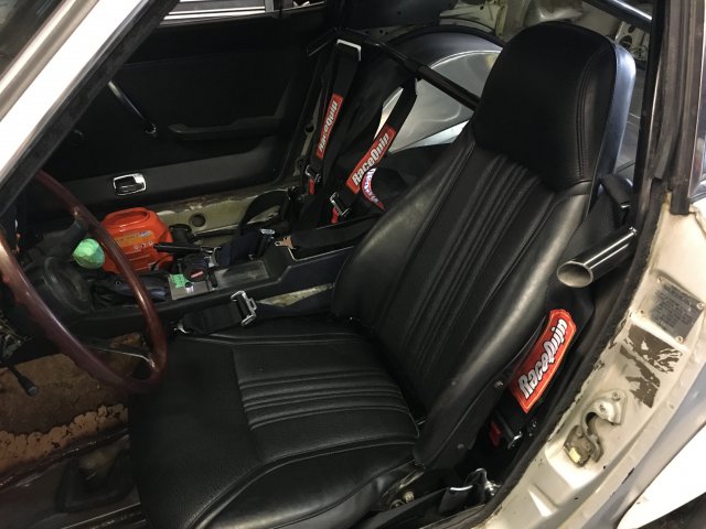

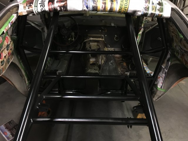

Full cage and Chromoly from the engine compartment back
4 Link suspension
All Speedhut Gauges
Aeromotive Fuel System, A1000 pump
Car will get paint and body work done next year!
I have way more pics but posted the important ones lol.
Let me know what you guys think!!

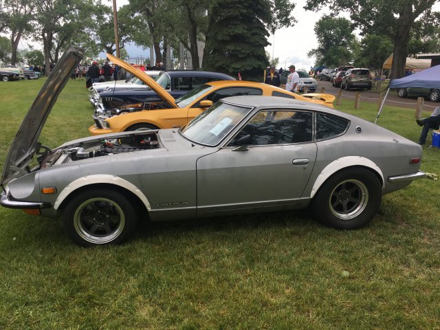

  On 7/16/2018 at 3:40 PM, weedburner said:
Your Z and my RX-7 would look good sitting next to each other.

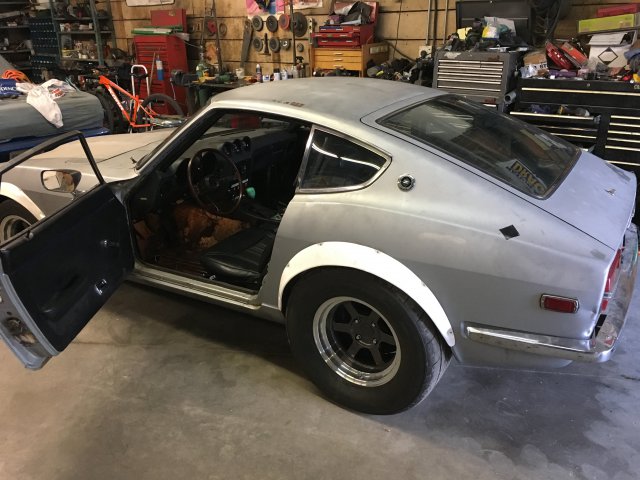

What weight, rear gear, and tire size? My RX is 2325 without me, 3.73, 275/60-15 also with a manual trans, ran 5.73 back when it had 700whp.
Expand
I love RX7s. I’m not sure what it weighs yet, haven’t put it on a scale. I would say closer to 2,500. Rear gear is 4.11, tires are 335 60 R15. I’m hoping for 500rwhp. If lower that’s ok right now, haven’t done any tuning, the intent is to add a blower down the road. Has 10.5:1 compression right now.
Thanks for all all the compliments guys!!
