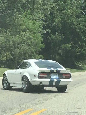

jvandyke Posted July 23, 2018 Share Posted July 23, 2018 (edited) my kid (17) either inherited or absorbed his old man's car infatuation, a couple weeks ago, while he was trolling craigslist for his usual favorites, he comes across an X-drag car (streetable), '72 with a zz4. Was made in Carson City back in '96/97, somehow found its way to Michigan and into our greasy little mitts. It's pretty far from it's former glory, a little (VERY little by Michigan standards) rust but ratty interior and tons of flaws, but she runs and goes like stink....most of the time, anyway First question and most pressing: It's got a zz4 with a Holley 670, stumbles very badly on tip in, drops to idle, usually recovers, you can tease it along. Gets better when warm. So far research shows many jet up a bit but not sure what's in there now, going to pull it apart and see. (a few minutes later: 65 primary, 68 secondary, not that I would know but that seems kinda small found this thread that suggests 68 primary, 76 secondary) running an automatic, TH700r4 I think. B&M Hammer shifter that is very FUBAR'd, hard to find a gear, once in she shifts fine. I plan on running through the set up procedures and adjustment may solve it. Anyway, happy to find this resource and hope to glean pearls of wisdom from y'all. We have a fascinating collection of old receipts (including a stack of drag times) so have an idea what's in there but who knows this far down the road, ya know? Edited July 23, 2018 by jvandyke add to gearbox info Quote Link to comment Share on other sites More sharing options...
