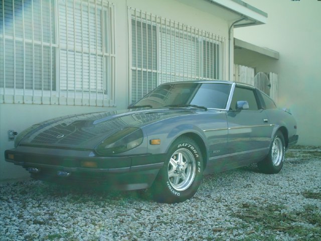

Tonyorlo Posted November 15, 2018 Author Share Posted November 15, 2018 Is MSA the best place to purchase the coils from? The car has newer struts on it, so I hate to replace them but if I have to then so be it I guess. I have not really price shopped for these parts yet. My plan is to replace inner and outter tie rod ends, as well as the ball joints. I didn’t plan on Wheel bearings unless it needed them, but if I am going this far why not. This is not my car, it came across on a google search. This is the ride height and stance I want to achieve. Quote Link to comment Share on other sites More sharing options...
G-Tech Posted November 16, 2018 Share Posted November 16, 2018 yes they are the best place to buy them from. if you spend some time looking, you might find them cheaper but msa is the best if you just wanna make sure your getting the right thing. before you buy inner tie rods, look into what it takes to change that. i just did outers. and dont bother with wheel bearings unless they are bad. if you ever do front brake rotors, you will have to change them then and doing the rear wheel bearings involve pulling the stub-axles out. the pic looks like what you should end up with with eibach coils. there is only 1" drop coils for sale and thats it, anything more and your getting into coilovers. Quote Link to comment Share on other sites More sharing options...

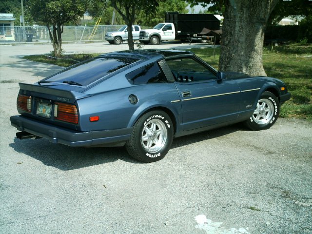

G-Tech Posted November 16, 2018 Share Posted November 16, 2018 this was mine with the 1" lower springs. way,way,way back Quote Link to comment Share on other sites More sharing options...
Tonyorlo Posted November 17, 2018 Author Share Posted November 17, 2018 I really like that ride height, still driveable. Do you know what size tires you ran in those pictures? Just thinking, can you run a little more backspacing on the rear without rolling the quarter? I like the headlight covers, it looks like yours were just smoked and not blacked out? Quote Link to comment Share on other sites More sharing options...

G-Tech Posted November 17, 2018 Share Posted November 17, 2018 Headlight cover are just regular tinted ones. Tires were stock size. You can go lil more offset. I have 17x8 0-offset on the rear now with 235's. Stock 14's are only 6" wide, I wouldn't go more then a 225 but I've seen people do things I wouldn't Quote Link to comment Share on other sites More sharing options...
