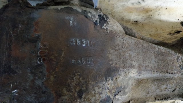

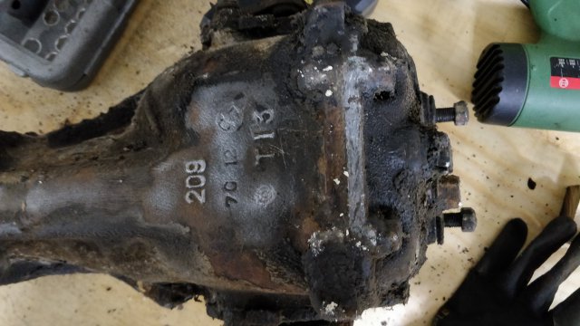

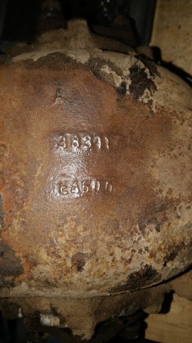

ubergumgum Posted October 2, 2018 Share Posted October 2, 2018 Hi, I got really unsure what differential i have it should be a r180 but would like some one to confirm it for me! This is what i can find on it! Quote Link to comment Share on other sites More sharing options...
jhm Posted October 2, 2018 Share Posted October 2, 2018 Yes, R180. If you're wanting to know the gear ratio, the only sure way is to pull the back cover -- the ratio is stamped into the ring gear. Quote Link to comment Share on other sites More sharing options...
NewZed Posted October 2, 2018 Share Posted October 2, 2018 Or, if you can count to 4, you can just turn some parts and calculate. Let's not make the world too simple. Phones are softening enough brains already. If you're trying to be sure it's limited slip then pulling the cover is advised. Ratios - too easy. Quote Link to comment Share on other sites More sharing options...
ubergumgum Posted October 3, 2018 Author Share Posted October 3, 2018 alright, thanks. will probably pull the cover to make sure everything looks alright in a later date. have to much rust to fix at the moment Quote Link to comment Share on other sites More sharing options...
