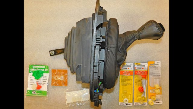

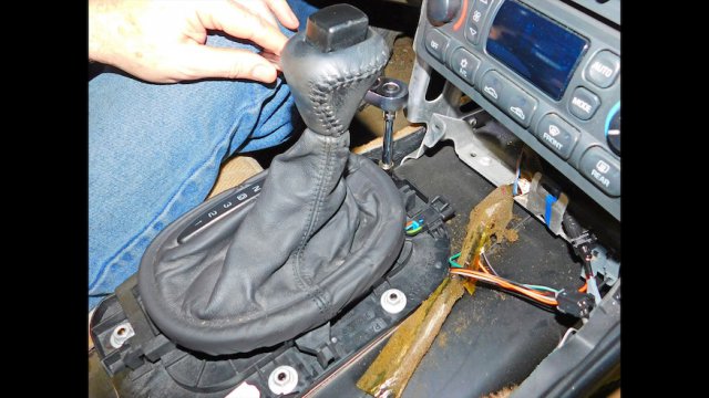

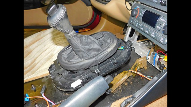

Hey guys. I still need to figure out a shifter solution for my ls1 with 4l60e. Most of the threads I see are pretty old so I wanted to check if anyone has an update. I am looking for a cost effective (cheaper) solution like a stock used shifter.
im leaning  towards a c6 corvette shifter. I already have the transmission in so I would also like something that can be done from mostly up top. Can I do it without welding?
let me know if you have any good solutions.
17427907-0DBB-44B5-813B-CA6C17008B8E.jpeg.52e341cd9a2688ff08fc44a419a8279d.jpeg03BFF5B1-AB6D-4DEB-96E5-E83EB479FF60.jpeg.5ac44dc3d9de8b8c6fdfa9052b0dc1d1.jpeg287A403A-5E22-4843-847A-651E3235F986.jpeg.a26ea07c0c3274da10d08e3bf53ce1f1.jpeg
