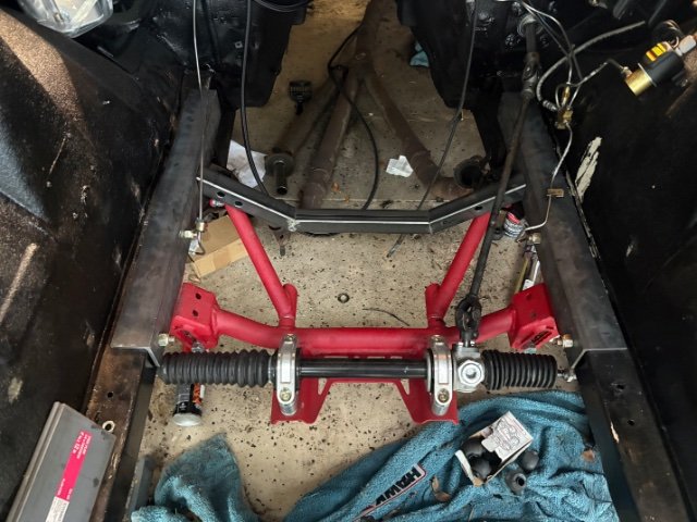

FastFloridian Posted November 16, 2024 Author Share Posted November 16, 2024 (edited) Got the fenders and cowl off, everything underneath looks pretty good, just a little surface rust. Header bolts were coming off pretty easy, I sprayed them with pb blaster a few times during the week, did the trick. A couple were hex bolts for some reason. Hopefully work on it a little bit tomorrow too, would like to get exhaust and headers off, and maybe the drive shaft. Ordered a few parts too, front strut brace, fender brace, master cylinder brace and a new steering rack from Apex. Hopefully my electric power steering kit will be ready to pick up next week. Edited November 17, 2024 by FastFloridian Quote Link to comment Share on other sites More sharing options...

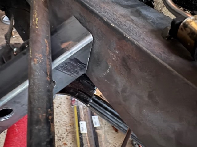

FastFloridian Posted January 19 Author Share Posted January 19 Unbolted the driveshaft today, not enough play to get it out, but should come out when pulling the engine trans I guess. Picked up my first welder, going to practice for a few weekends then try and weld these fender braces in. 1 Quote Link to comment Share on other sites More sharing options...
