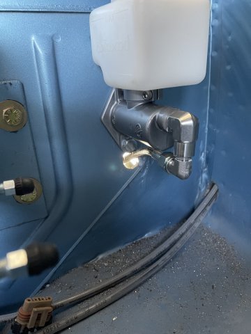

A to Z Posted October 19, 2025 Author Share Posted October 19, 2025 Today I got a good start on the engine compartment, and also fitted the brass oil port screws to the 4200 block. The engine compartment will be factory color, with clear coats, and the engine compartment will be shaved, I also went ahead and bought a rewiring kit for the car form Jeg's. Quote Link to comment Share on other sites More sharing options...
A to Z Posted October 22, 2025 Author Share Posted October 22, 2025 I started at dark this morning, and got the seats, center console and dash out of the 260Z. prepped the holes in dash and they are now plugged and curing. then I took some time and just gutted the whole area, to include the dash. Finished at 1:40 this afternoon. 1 Quote Link to comment Share on other sites More sharing options...
A to Z Posted October 23, 2025 Author Share Posted October 23, 2025 tonight I pulled the tape, it had cured enough, it will continue to harden even more. This is not "just filler" or bondo.....it is 80% aluminum filings and 20% resin. It will not shrink, it will not crack, it is hard as a rock. They poured resin over the Pharaoh Tutankhamun's body, and 3500 years later, to get him out of his coffin they had to chip him out......so it is permanent. ALL METAL Filler. wear gloves! It reacts on skin and burns like there is acid in it. Quote Link to comment Share on other sites More sharing options...
