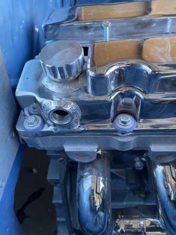

A to Z Posted December 11, 2025 Author Share Posted December 11, 2025 I picked up my bellhousing and serpentine bracket for the 4200 engine today from the powdercoaters. The finish is called "polished aluminum". I had them done because frankly both pieces were ROUGH....really rough. R&S Powdercoating in Colorado Springs came through for me again. Sandblasted it out, masked off the gasket surfaces and did their thing. Quote Link to comment Share on other sites More sharing options...

A to Z Posted December 14, 2025 Author Share Posted December 14, 2025 12-13-2025. I installed my new water pump, repainted pulley and new hardware, and then re-installed the tensioner bracket and the aluminum plate needed for the additional of an idler pulley to make it all work right. I was able to use a drill bit to hold the pulley in place and measure for the spacers needed and the length of the longer bolt needed. I went to install the alternator, but the kit I got sticks out just a tad too far, and thus the alternator hits the rail.....so I will have to grind down the bracket to bring it in closer to the engine and then it will be fine....also found that my new drive by wire throttle body does not clear in standard configuration, So I was able to get it to work by turning it 90 degrees. Here's to hoping that will work. Then I quickly installed my new 4 core radiator and dual fans to check the fit. because my engine has the radiator spigots on opposite sides, I will be taking my radiator to my fab guy to cut the hose ports and welding on tight 90's with a length of pipe to the other side and then another 90 to make it a nice-looking remedy. I will make some nice aluminum brackets to hold the piping stationary. At any rate, I was able to verify that my radiator height is sufficient to maintain its place as the highest point in the system. After this, I cleaned out the garage, and went through a lot of boxes and prepped the car by covering the engine and front end to begin the sanding and block sanding, to get the rest in paint. I pulled the windshield, but after 51 years, it just didn't want to let the windshield go, and so it came out broken and in pieces. Not a crisis, as I wanted a new windshield anyway....just thank good ness the rear hatch glass came out just fine. I pulled the old hatch off, gutted it and to the dumpster with that rotten thing. I was also able to get a bit closer on the front blinker restoration, getting the housings painted white with rustoleum white. spray paint Only thing left is to lengthen the wires. I tri4d to wire wheel the headlight buckets, but decided they really just need to be sandblasted out. My mobile welder didn't make it today, so welding the clothes hangers in pieces to the front edge of the doors to close up a big gap will have to wait. Here comes sanding and blocking. Quote Link to comment Share on other sites More sharing options...
