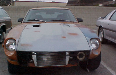

Tony,
I hope you have a lock on that I/C hehe.. Look like someone could just walk by and jank it right out and kept walking hehe.. Anyway I am in the process of doing the plumbing for my I/C on my 79 280ZXT and I already waste more than 2 days from just planning.
